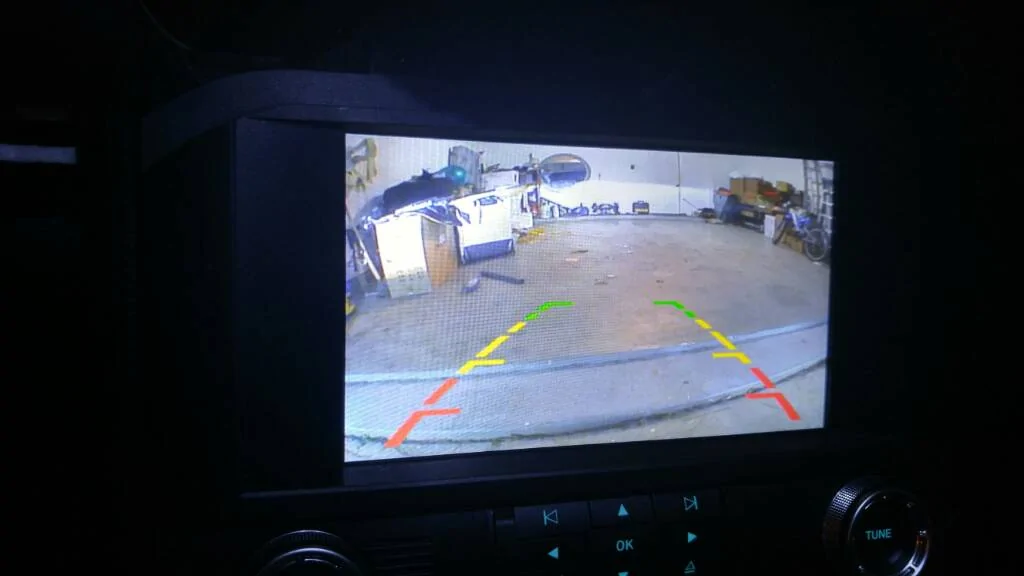

Android phone with Mhl cable works just fine . tested with note 4.
Beside , here is update : front camera works perfect ( connect to the second yellow cable, 1st one for screen mirror )
Sent from my LG-H811 using Tapatalk
