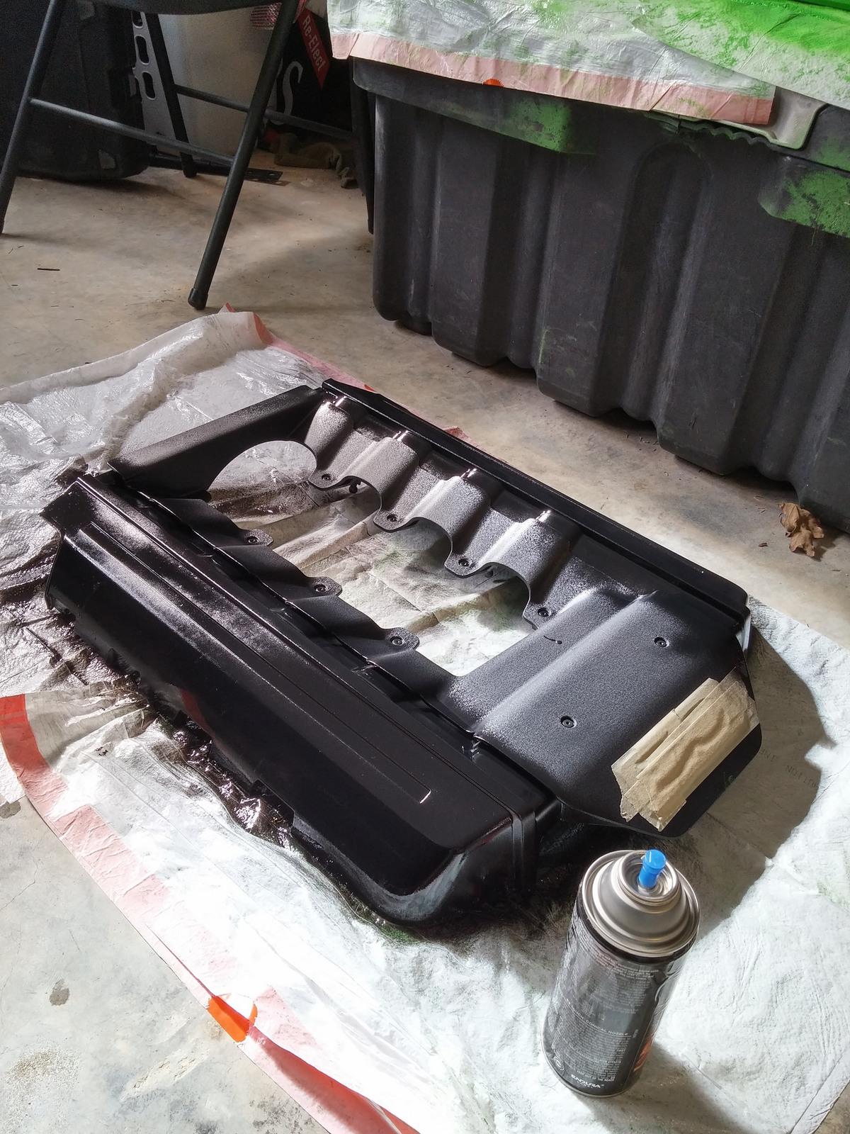

How are you doing the 2 tone in the recesses. Are you taping, hand painting, filling with grease?
I blue taped mine. Used an exacto knife to cut the shape of the letters. I taped those off first then, sprayed the black. I waited until that dried completely then used the outlines of the letters and sprayed the letters the red. I used a q-tip to fix any small imperfections.

My prices are more then reasonable. Like the one I did You paint the whole cover then put 3 coats of clear on sand smooth then mask of and paint the indentations and use an air brush on the lettering. Remove tape clean any edges that need cleaned up and then another 3 coats of clear will look wet as water
