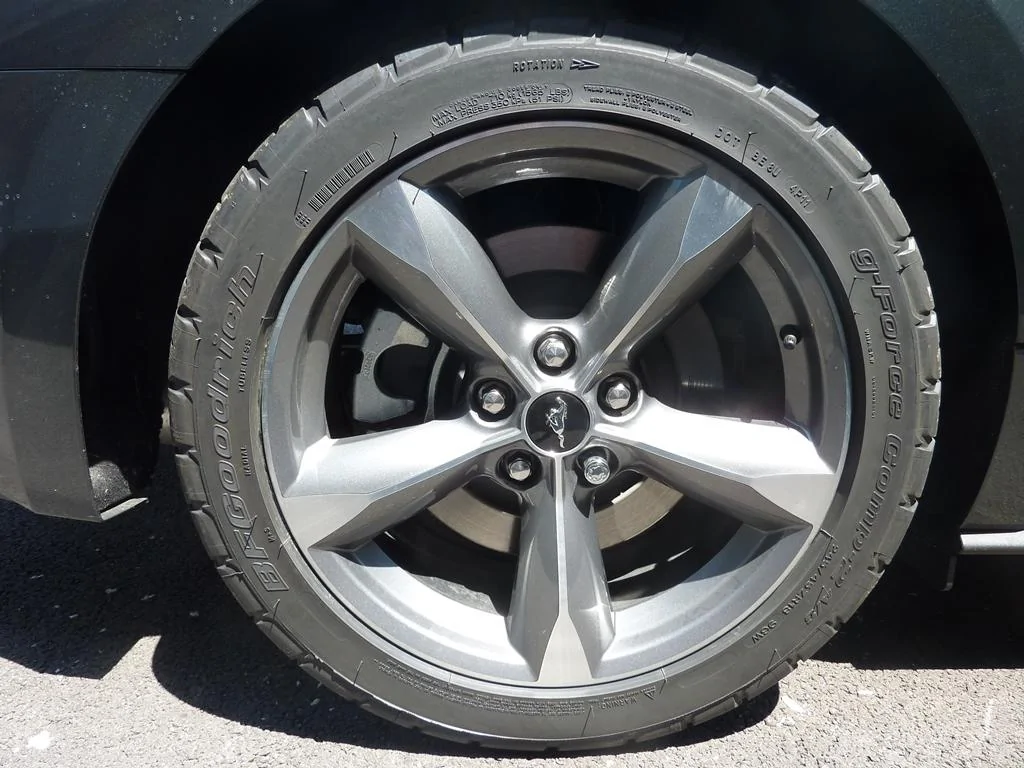

If that is Tal's left front tire that he posted, then the rotation looks wrong.
Its true, that tire is on backwards and the tires are indeed marked directional.

Nope...it's the right (passenger) side. :like:
