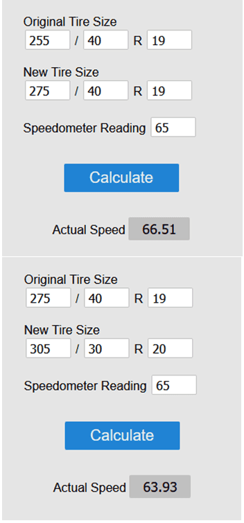

I just changed the tires on mine from 255/40/19 up front to 275/40/19 and 275/40/19 on the back to 305/30/20. I used this website to get an idea of what the speedometer will do with these changes.
https://tiresize.com/speedometer-calibration/
These were the results. I don't have Forscan or plan on getting it. Driving in California you are going 80 MPH anyways just to keep up so 1 MPH isn't going to hurt.

I think the speedometer is only from the rear tires. If I'm wrong please correct me.
You would think so. The website only does one calculation at a time so it doesn't know if it's back or front. Coud be RWD or FWD.
Calculated by the drive axle. That's why Forscan asks for the tire size of the rear wheels so it can calculate speed.

You need to plug in 305/30/20, as the speedometer reads from the rear tires on a Mustang.
I don’t get what you are saying? I really don’t care about the speedometer as I go as fast as I care. What is the question?
