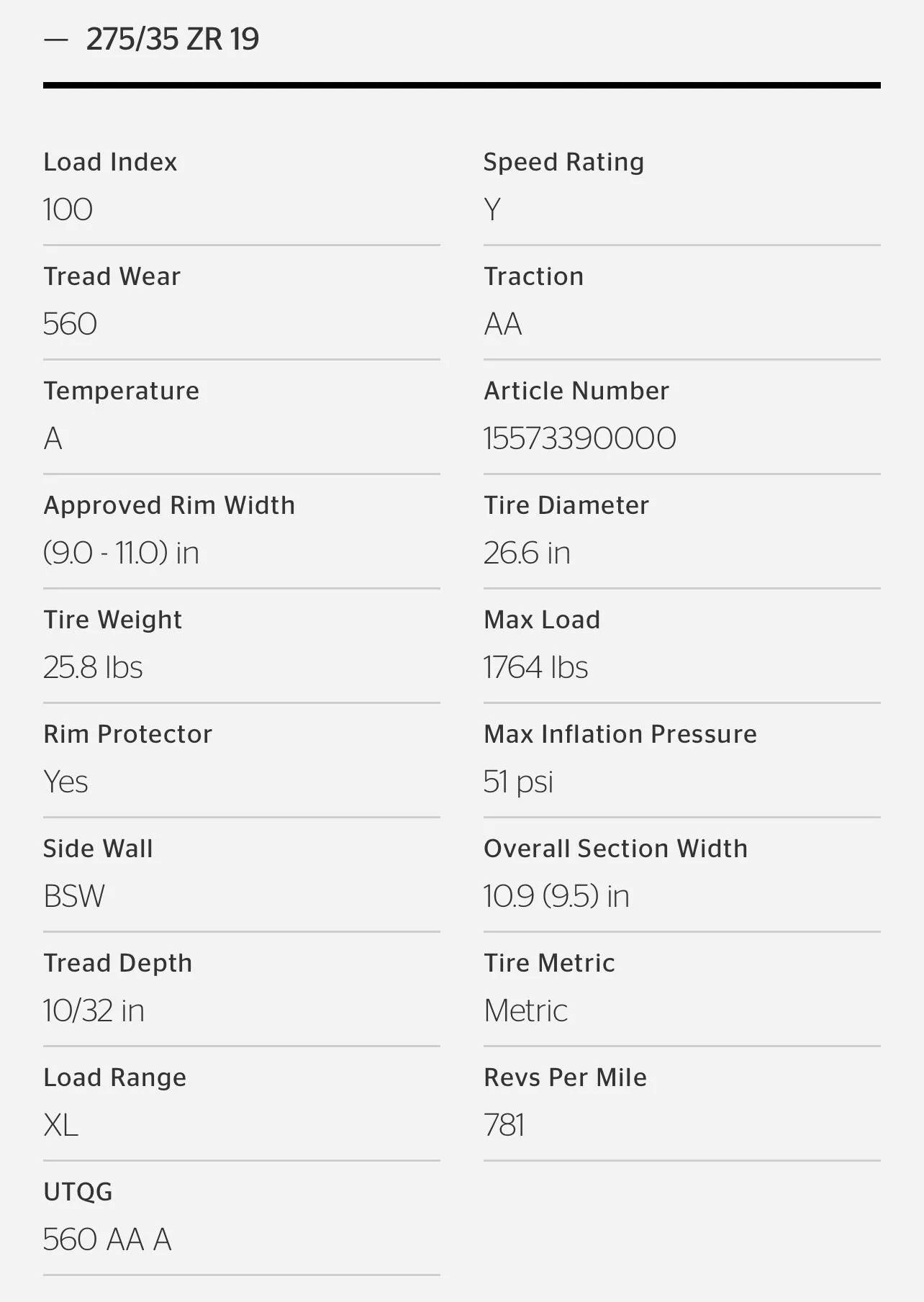

I have CONTINENTAL EXTREME CONTACT DWS06 PLUS.
I think I’ll inflate them to 32psi while it’s still cold out.
Good to know (19" DWS06).
FWIW, I would not run those Continentals at a lower than normal pressure.. The contis sidewalls are usually on the soft side to start with, which gives them good grip in daily driving and wet conditions, but at lower pressures you've got a soft sidewall with even less support from the low air pressure, so the tread would be moving around more than you'd probably like as you change directions. In a straight line you may not notice, but a quick lane change on a colder day and it could get scary.
Anyway, 32 cold pressure should be fine, or a couple lbs higher.
