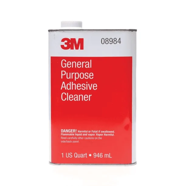

Steam is the best method. Hot water will probably work but it will take take longer. I'd look for a rental steamer.
For any remaining adhesive, go to a paint store and get some 3M Adhesive Remover. I think Walmart and other places carry it as well.

If you can rig that steamer to provide a slow to medium flow from something like a Shop Vac hose, it will probably work fine.
Soaking paper towels with adhesive remover and then laying them over the stripes with a towel on top overnight will definitely help, too.
