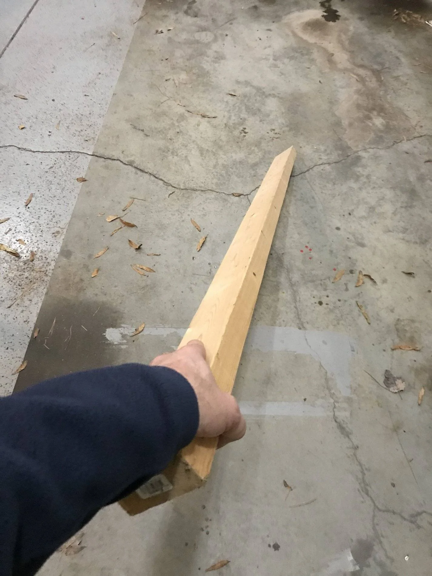

If you have power seats, use a 2x4 between clutch pedal and seat to push and hold clutch to the floor. The clutch spring and perch almost falls out.......I did pad it with rags so there was no rubbing......

Not sure what 2x4 is, but I can imagine to put some kind of rod between clutch pedal and seat upholstery and then push the seat toward the pedal.
Great idea, rayban1 !

2x4 is standard size framing wood for houses, it isn't actually 2" x 4" either any more but its still called that. Probably outside the US you would have a different name for it.

2X4 - good for knockin' heads and pushin' clutches
Thank you for the explanation about framing wood. We know 5x10 cm "boards", which are called remelj.
