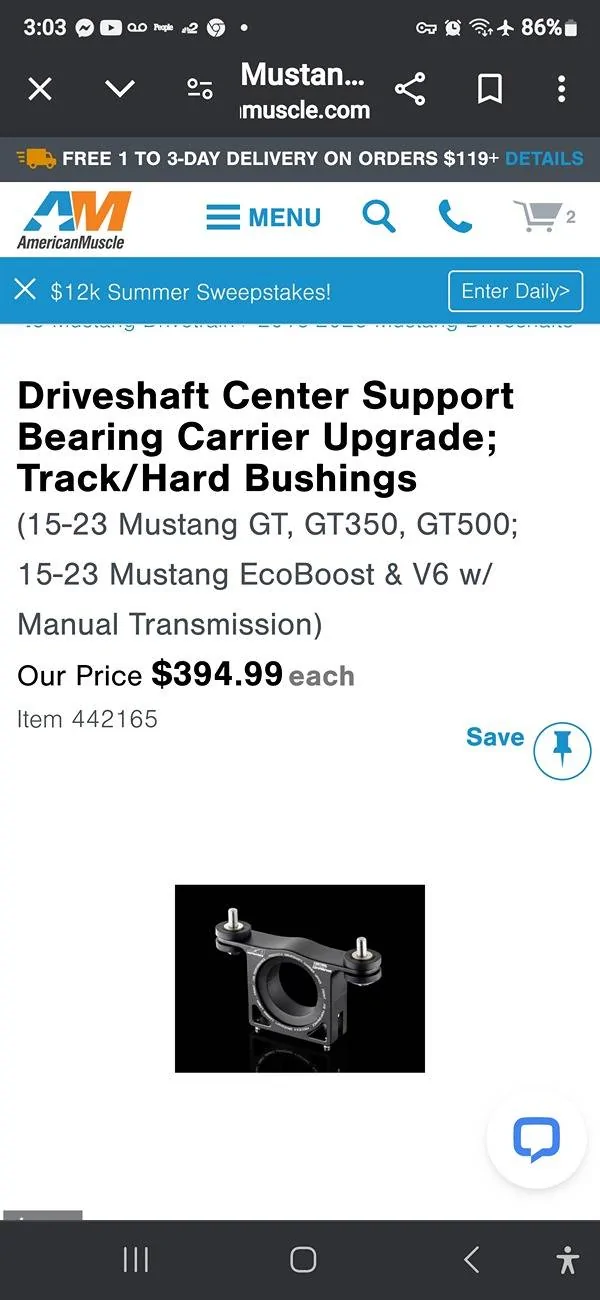

I would check the Bearing Carrier Upgrade
2019 10R80 car..I am hearing like a thud sound when going from drive to reverse and vice versa. I hear it on occasion when coming to a top as well and or when taking off from a dead stop. Its not a metal creaking noise nor is there anything rubbing or loose underneath. I have checked all the suspension and it all looks like new and is tight. it does it with the E brake on as well. Sounds more on the passenger side rear diff area. Any suggestions on where else to look or what to look for?
I would check the Carrier Bearing

Thanks and will do. I am going to put it back up on a lift this weekend and see what we can find. It has to be something not working as it should be.

I willing to bet it's that
I'll check mine out as well. Could you elaborate more on the carrier bearing upgrade more? And also how to check it and if there's a part number for the upgraded part?

If you put it on a lift and have a second person in the car, have them keep the brakes applied and shift from D to R and back again repeatedly, you should be able to find the source quickly enough.

19 s550
jxb makes a carrier bearing upgrade , i have one and still havent installed it since i got it in april . You have you cut you old one apart and bolt this one over whats left. They make them for tons of cars and the only complaint i could see is the price, everyone who has one is happy with it , lots of happy people , i just need to get around to it .
