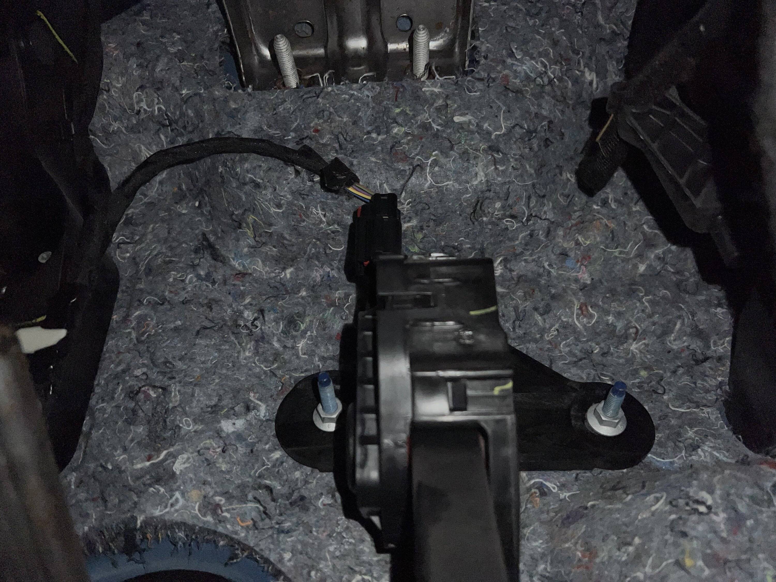

@Fromdabrazyy, it may be worthwhile to look to see if there is a throttle controller on the vehicle already. Some of them contain a valet mode / limp mode which might explain. I am not familiar with all the various brands, but you'll likely see some custom wires above the gas pedal and/or an extra plug. See the attached photo for the black plug that the Soler TC uses and plugs in right at the top of the gas pedal.
I would definitely take a look above the gas pedal for any custom wiring our plugs, first.
