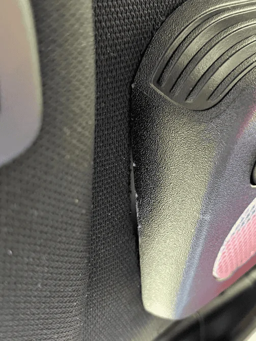

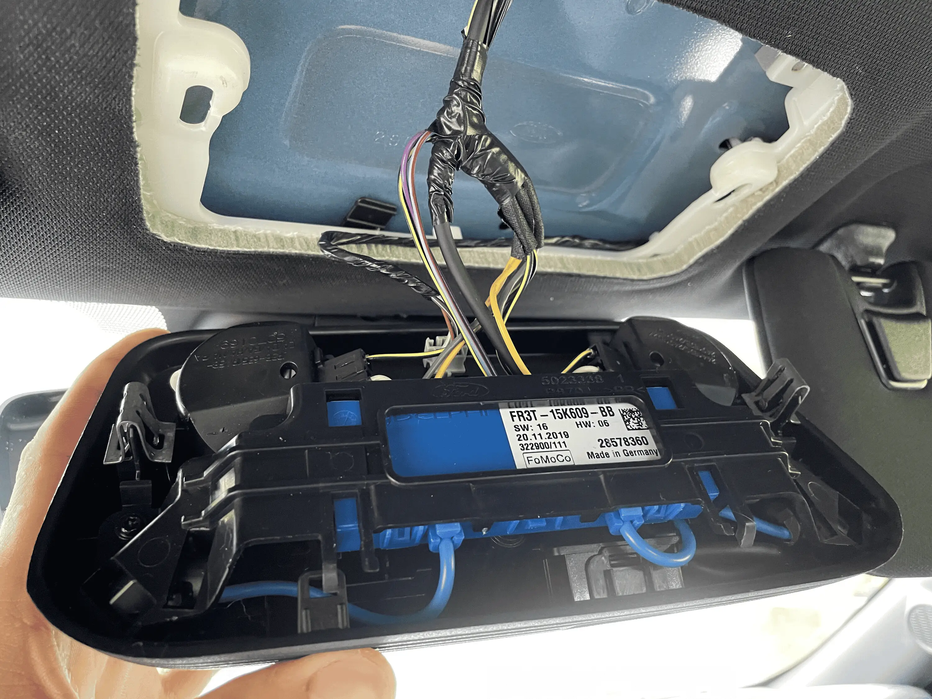

The Light at the top of the headliner (two lights and the center that tells you the passenger airbag is on or off) is currently lose. Supposedly this is a known situation to happen if you mess with that area at all, however JLE did not let me know of this.

Saw you on reddit, haha. You're way more chill about that then I would be, they did hack job work at best. They probably broke the clips on that headliner piece which is why it's loose.

There's no excuse for this. That's carelessness with a flathead screwdriver and maybe needle nose pliers. You should be able to fix the gaps between the map light and headliner. Sucks that the incompetent a-holes marred the plastic and creased the headliner.
Drop the map light using plastic tools. Here's how I did it:
https://www.mustang6g.com/forums/threads/boosted-and-interchillin.170024/post-3585808
If the map light is loose or sagging they probably bent the white retainer bracket behind the map light downward while removing it. You can push the bracket mount points back towards the roof using the butt of a hammer then reinstall light. You should also be able to stink some padding behind that crease in the headliner to correct that gap. Good luck!

I'll have to give this a go when I'm not playing catch up at work. I appreciate your help!

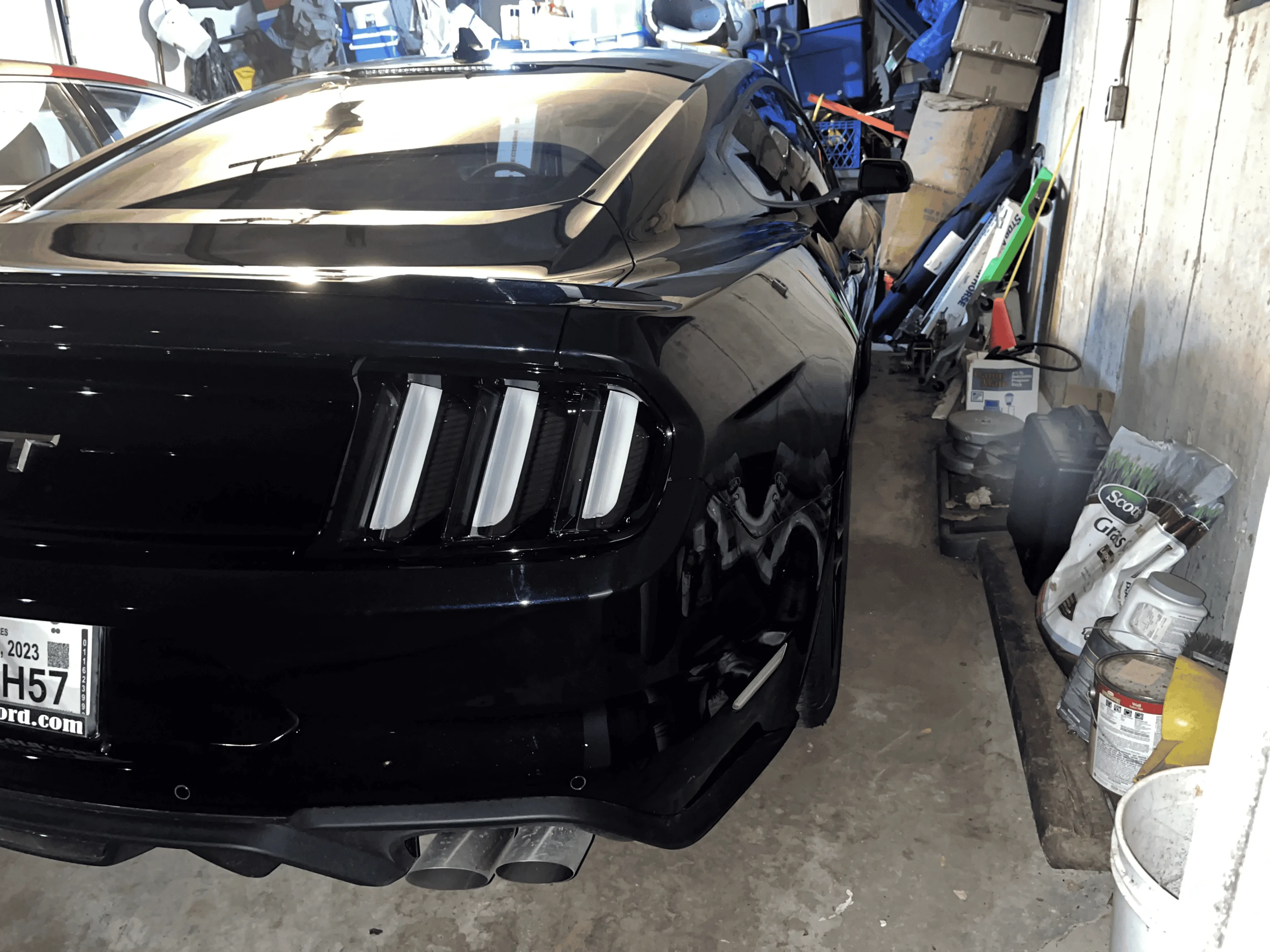

[Update 01/21/2023]

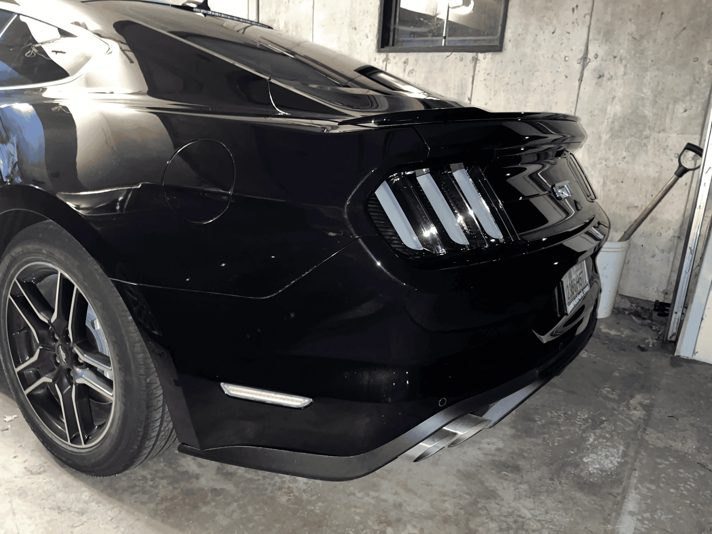

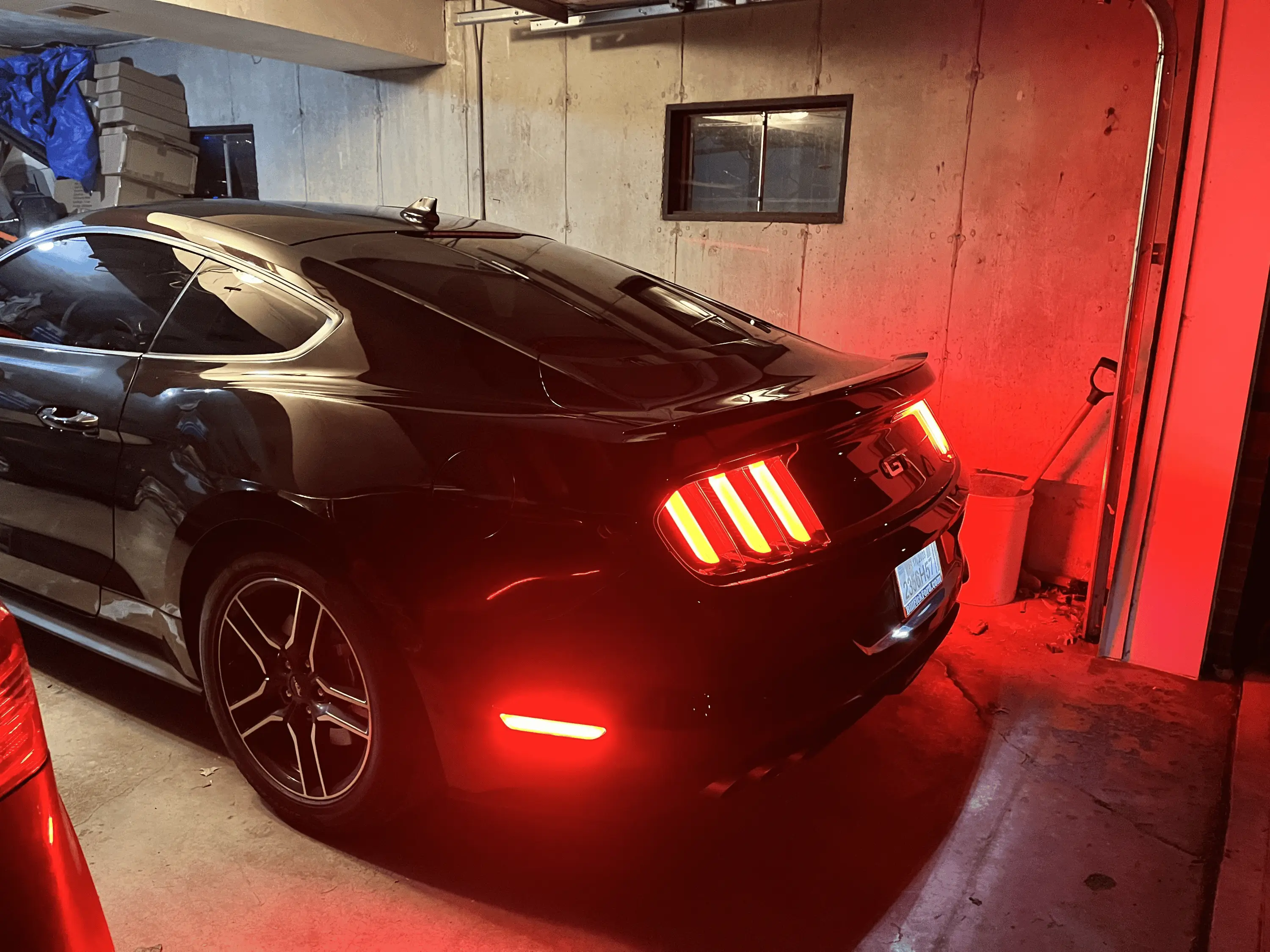

I was super impatient and decided to freeze my butt off installing some mods. Today I installed the
Raxiom Axial Series LED Side Marker Lights; Rear; Clear
Taillights Renegade Series LED Sequential 2015-Euro-Style With Black Housing And Clear Lenses Pair Mustang North American-Spec 2015-2022
Installation wise both were relatively easy. The Raxiom Axials you simply have to plug in where the bulb would be on the OEM plug. Simply use force and you can get the oem sidemarkers out (make sure you push it out on the right side (the one with the clip)).
The Taillights were plug and play which was great. The left side was super easy. The right side was a little bit annoying as for some reason there was a metal bar that made it difficult to get the taillight unplugged. Eventually I got it which was a super satisfying moment.
Here are some before and after photos:

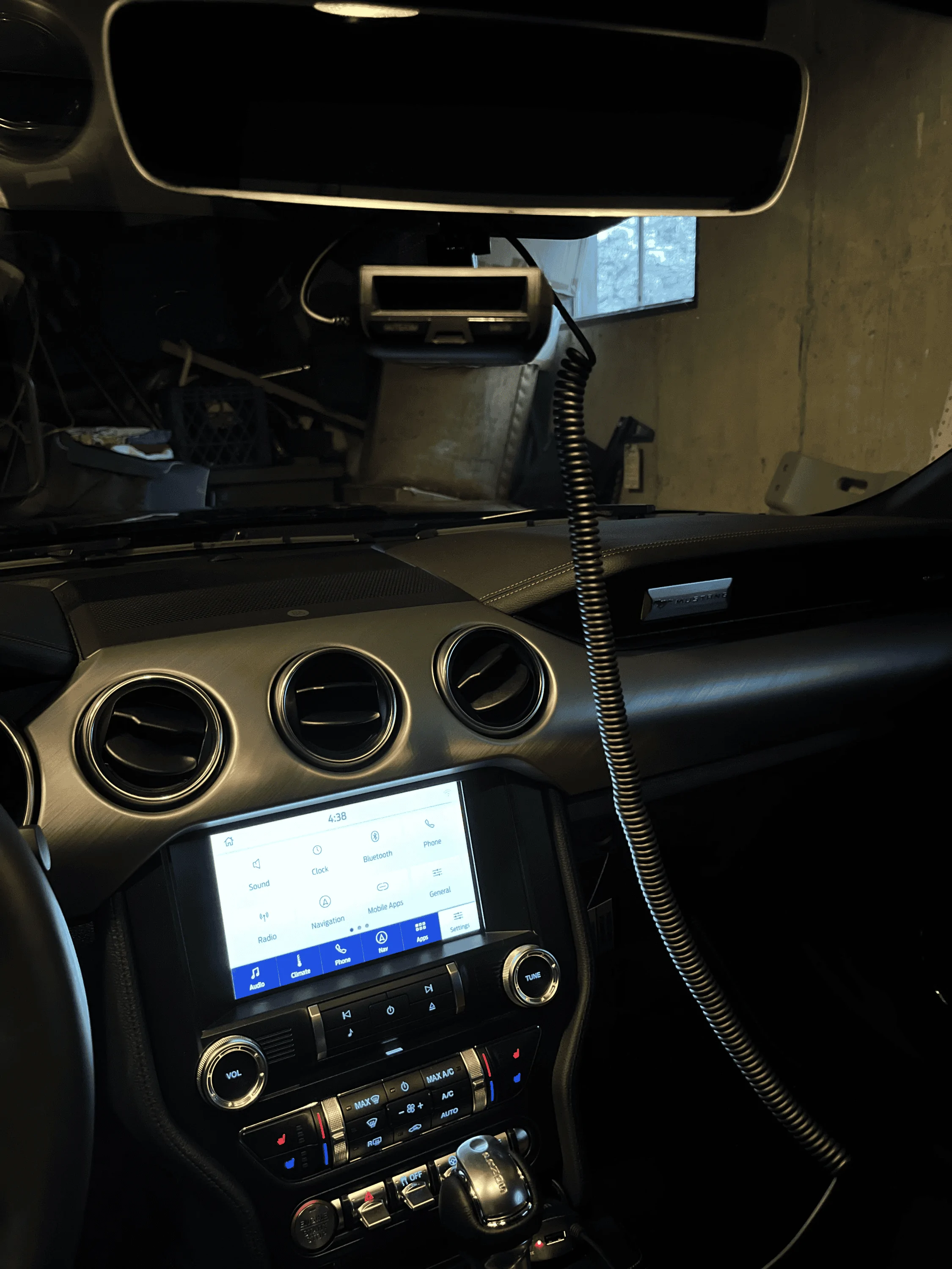

Honestly didn't think this even needed a post but I'll add it for now. I took down the broken Radar Detector Holder and my new one arrived today (Click Here for it). Just installed it and will hardwire it once I have time to bring it to the shop.

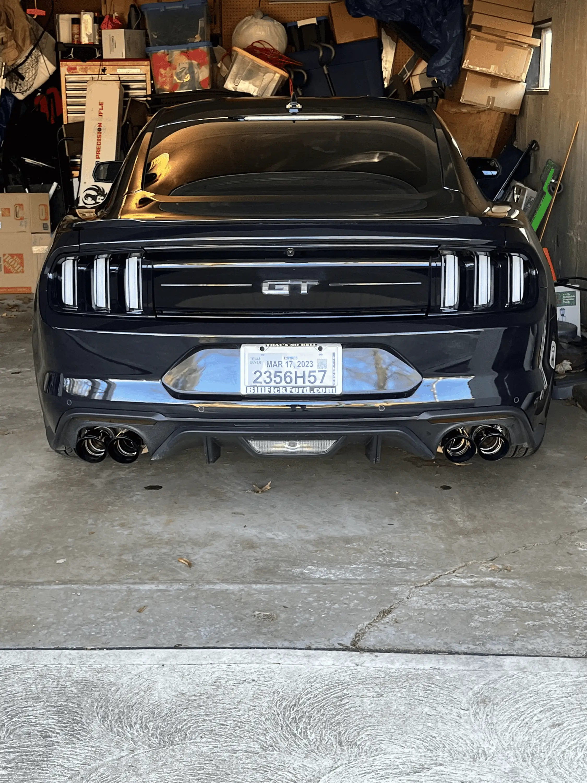

Update [01/23/2023]
Corsa Extremes (Active & Black Tips) installed. In person it sounds INSANE. 100% worth the money. @beefcake gave me a hella deal for anyone interested.

The thing crackles like crazy in sports mode. I'm very content with my purchase. Still trying to find a local shop willing to paint my MMD V Series Mischievous Purple. The ones I've reached out to are booked till Summer. Trying Ford Dealers now.
