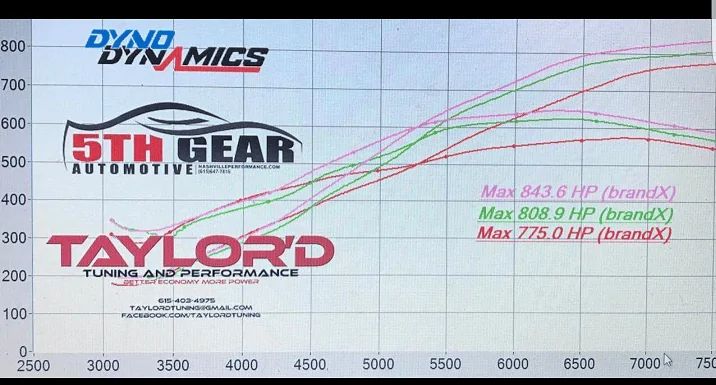

Your probably talking about Taylor Curtis. He tunes via NGauge & HPTuners. From quite a few of the guys around here, he knows his shit when it comes to the Coyote. I'm hesitant on letting him touch the Whipple though. But I think he just tuned a 700WHP Vortec S550 so. Idk. I've had a few tell me I can go E85 on a BAP & ID1000 since I am on the 3.75 pulley still and its lower boost I probably wouldn't run out of fuel so I considered going to Taylor and doing the HPTuners & E85, but. I'm Lund Dyno tuned now so, kinda pointless until I go to a 3.5 pulley and full exhaust.
Taylor is the man. He tuned my set up.
Red - Procharger D1SC, Sai Li Fuel System, id1050x, E85
Green - Procharger D1SC, Sai Li Fuel System, id1050x, E85, ARH Kittyless - Performance Tune
Pink - Procharger D1SC, Sai Li Fuel System, id1050x, E85, ARH Kittyless - Race Tune

Okay yea! It was yours I saw him tune. I'm in the 660Racing group. Lol. Car looks nasty man! I wish I had went auto, but I couldn't pass up the fact that the blower was already on the car when I bought it haha!
