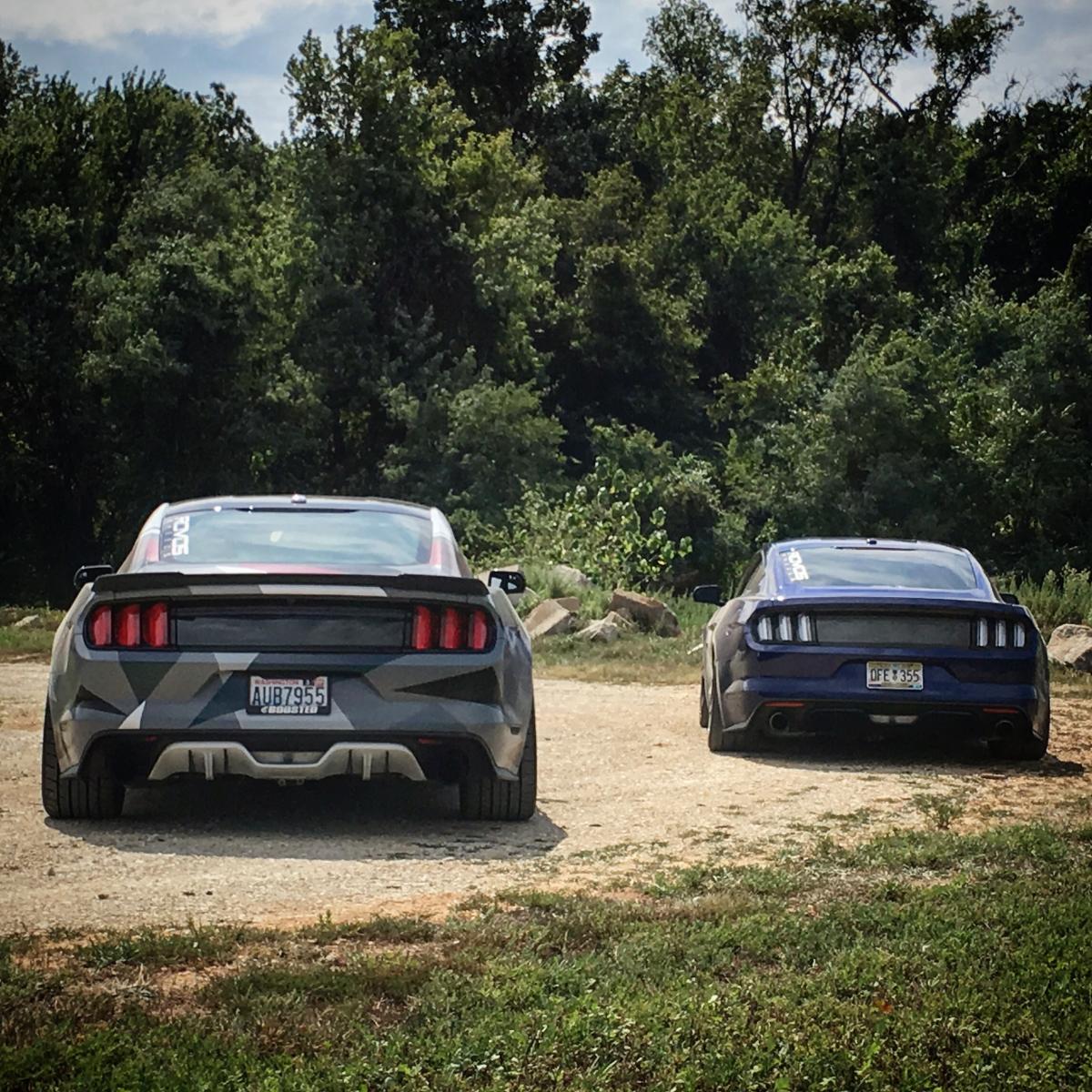

My friend has them and they are a pain in the ass to install.. Have to re modify the stock wires

Shame the euro aren't plug-n-play

The euro taillights are plug and play for the most part. Ordered a set from the UK for just under $800. They arrived at my doorstep in under a week.
I plan to "borrow" the connector plug/harness from a sequential taillight kit. (Keeping my oem set completely intact.)
