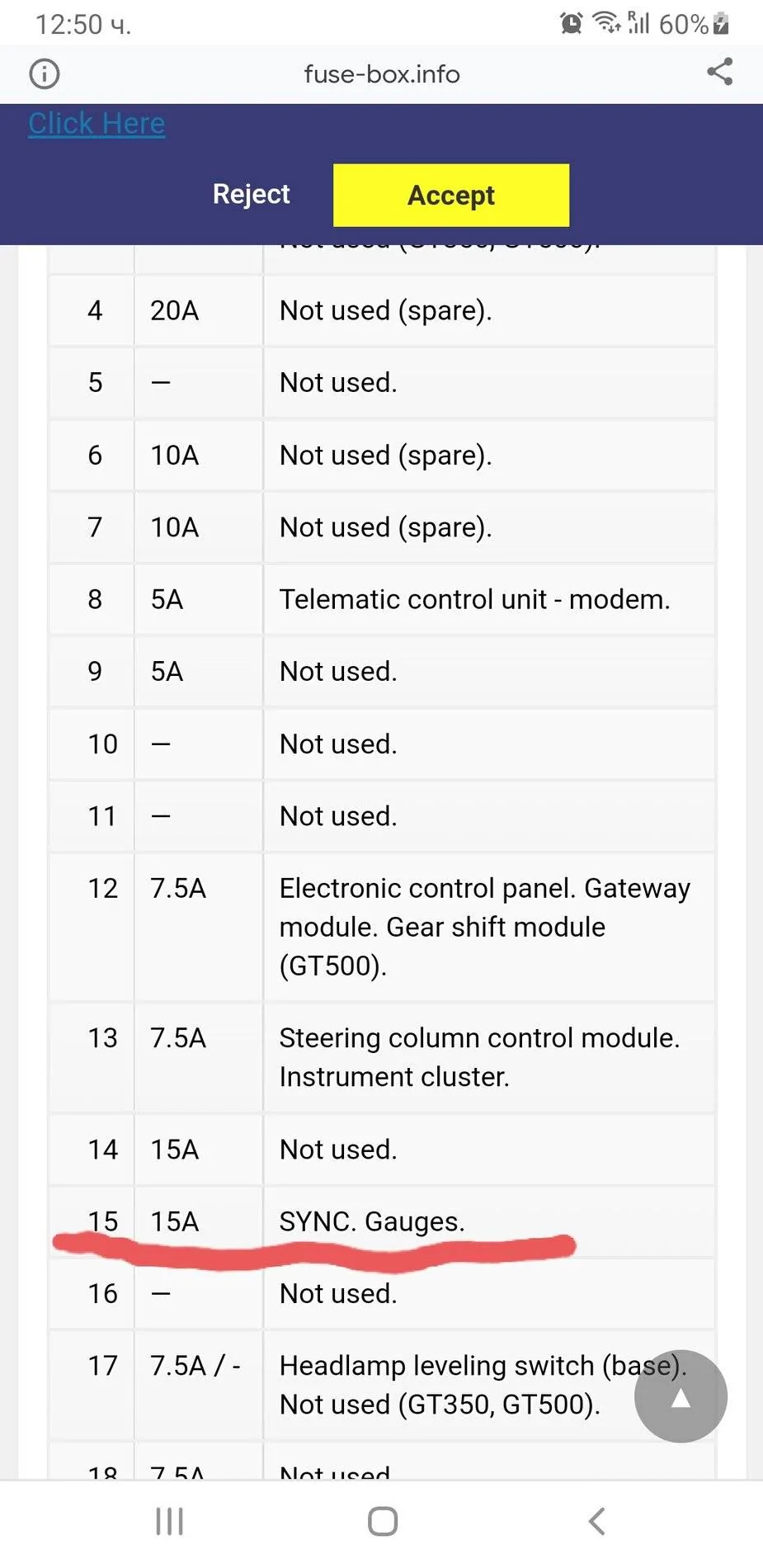

I tried disconnecting the battery - it didn't work. I'll check the fuse. I am currently in a foreign country and therefore cannot visit a Ford dealer. Would anyone tell me which fuse it is and where it is located?

Can anyone tell me if the other systems will work if I remove the multimedia fuse? To drive my car while they change my sync 3.
