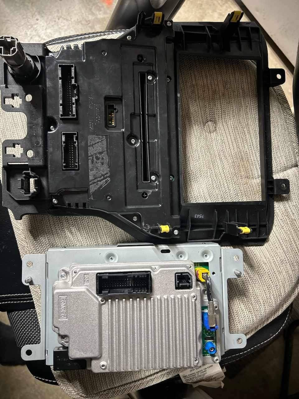

Thanks! So I just picked this up and I have no idea if it has navigation
