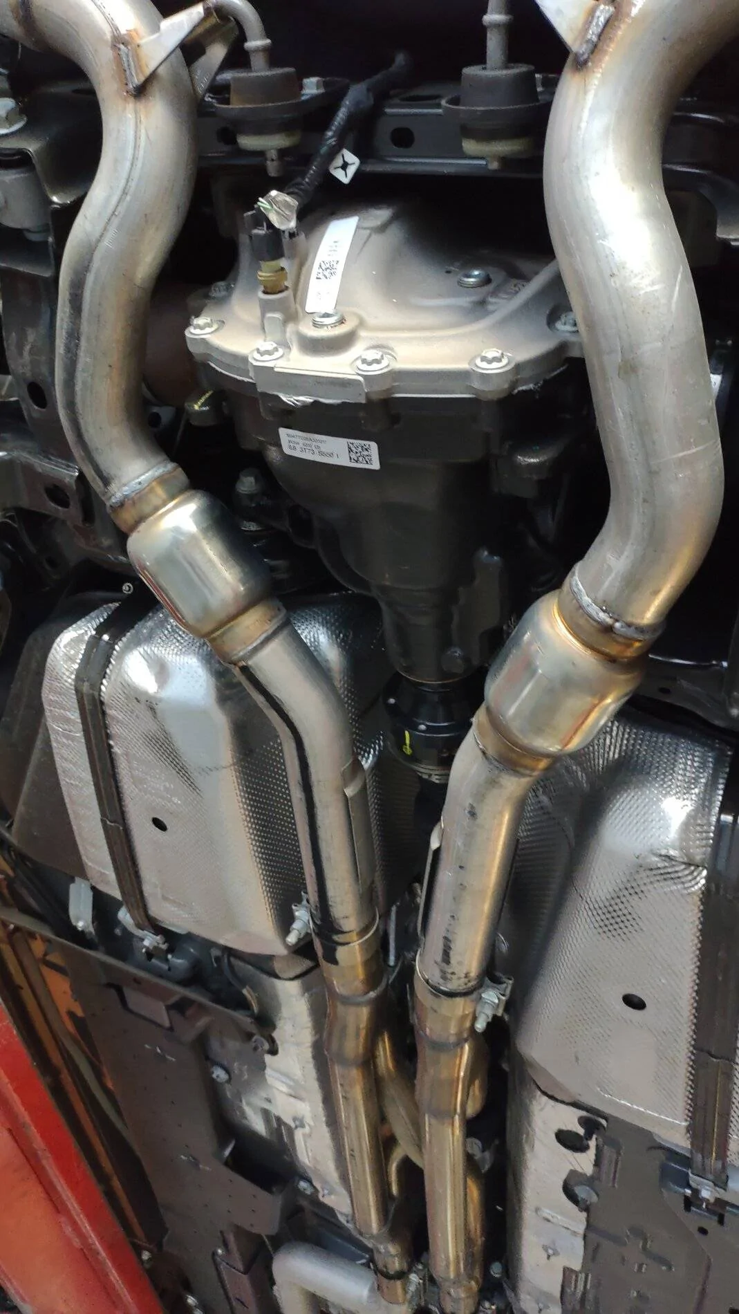

Just got back from the muffler shop, all welded in. It helped a lot. These are small race mufflers, it totally helped with it being trumpety and high rpm rasp. Had a small exhaust leak from behind the Borla Switchfire. Fixed that as well.

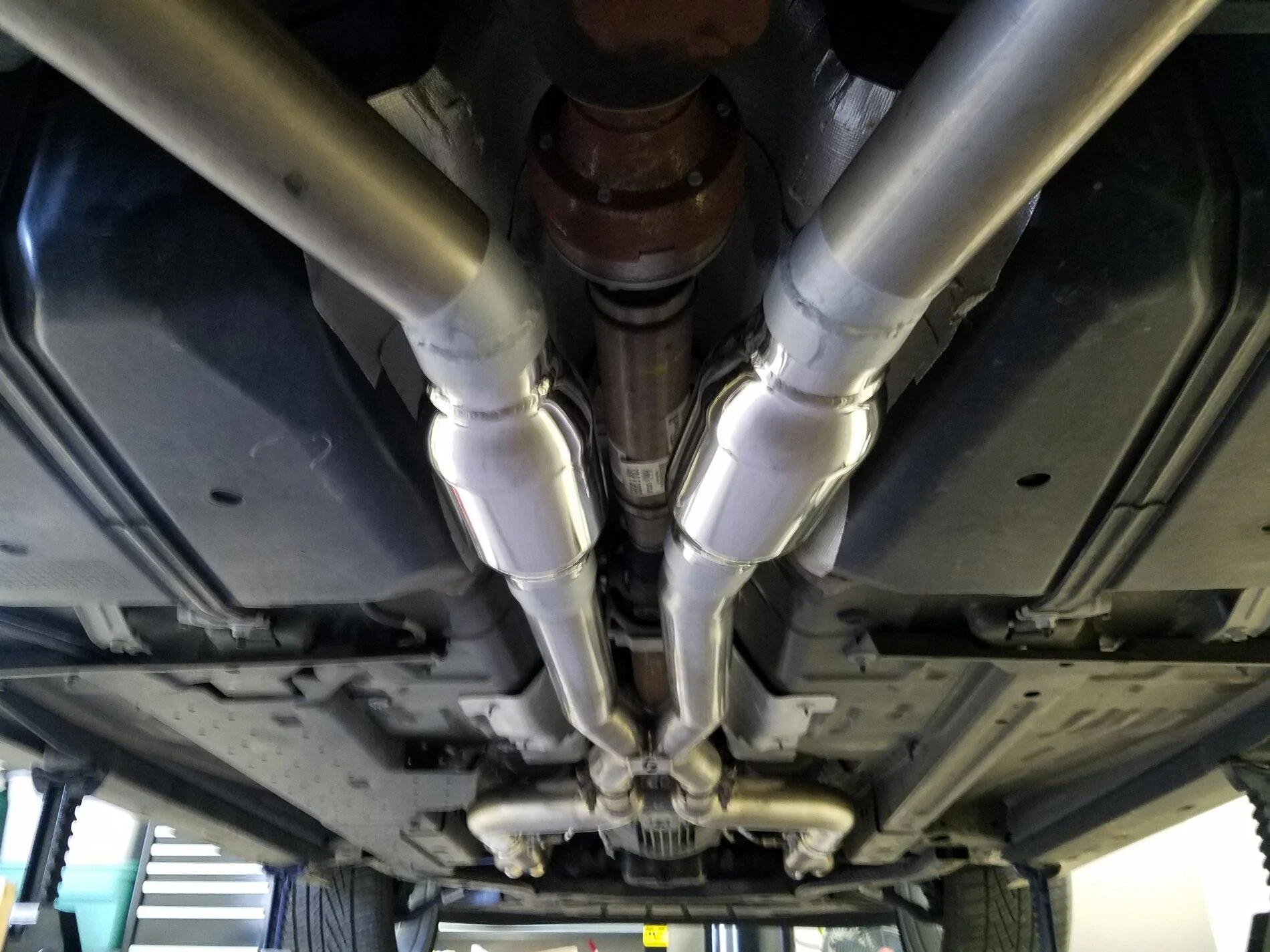

Seems to be a popular spot for locating the resonators. Here's my 2.5" vibrants installed on my FRPP Borla Sport with O/R long tubes located on the back of my Steed x-pipe. They are wonderful for reducing the rasp and taking so many of the harsh tones out of the exhaust. Love them so much I ended up replacing my factory resonator on my F150 with a longer version of this one after the Magnaflow MF cat-back I installed was too quiet...

Looks good, I had issue with removing the factory heat shields in that area though. Thats why I went with the smaller race bullit mufflers.

yeah i havent noticed any signs of leaking, the weld job seems pretty solid as far as that goes. I figure if it ends up becoming a problem, i can find something to replace it or get smaller ones welded in at that point.
the sound is much better. its pretty quiet at idle or at low rpms, but still pretty loud and sounds good when im getting on it. I dont notice any drone anymore which i will appreciate when i drive across country soon for my training.

it reduced sound volume considerably, rasp, and drone. Even on startup it is much more quiet now. If that's what you are looking for, then itll for sure do that.
Ive been told they have a break in period, so idk what the final result is yet if that's true, but so far it has done that for my setup
