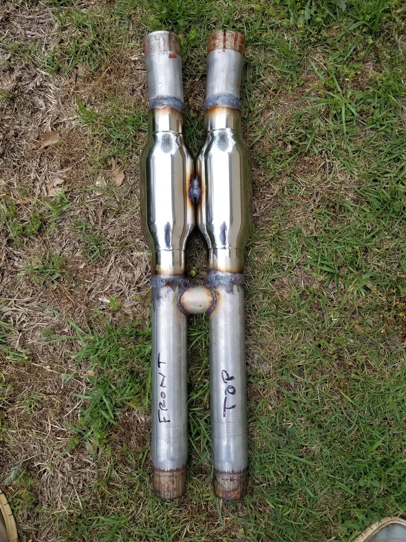

Im torn between that and on the MAK cat delete pipe. This is good if i never plan on changing the x pipe. Ill have to check again how much room mine has. Thanks for the pic! How did it help on your setup?
I didnt feel comfortable putting them where my mak cat deletes are. The straight run wasnt long enough IIRC
I had cat deletes, h pipe, and active exhaust. Part throttle was tooo raspy. It got rid of almost all the rasp but only took the sound level down just a tad. Exactly what I was wanting
Good info!! Honestly ill probably just bring both to my muffler guy and see what he thinks is best.
Glad to hear though! That would be perfect
