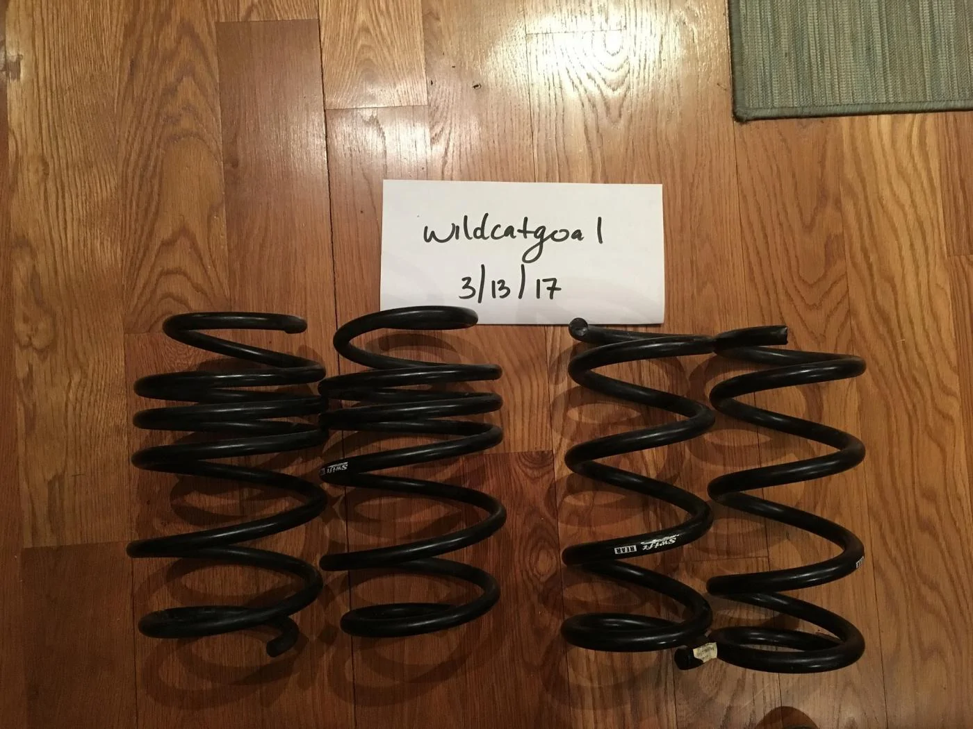

To use wildcatgoal's pic...swift front is a dual rate.
Ohh I see. I was looking at the spring chart and it was mentioned they were linear with 279lbs. Time to search for a used pair of rev A BMR.

Swifts are linear at curb/compression - so basically linear except when the weight of the inside wheel side of the is coming up in turns . Call Swift; they’re happy to explain the spring design. I felt they needed a stiffer rear spring. The front was awesome. A dual rate has obvious benefits for keeping the car flat in turns. Front and back I have dual rates... gonna need to set up a table at a college campus with a sign that says “Dual rate springs are great, change my mind,” to try and convince me otherwise! Haha.
