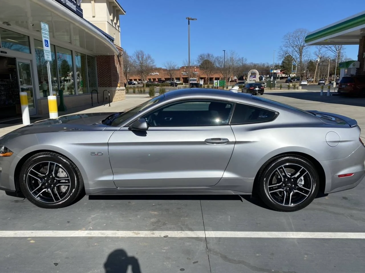

I decided I loved the Performance Pack spoiler so I found a take off spoiler in the correct “Iconic Silver” on EBay and today I swapped it out.
This process required removing the interior trunk trim panel, removing the 4 lock nuts on the spoiler studs and prying it up. There is a ton of 3M double sided tape, so I used the fishing line saw method. Lots of time spent cleaning up the tape residue and then retaping the PP spoiler and reattaching.
