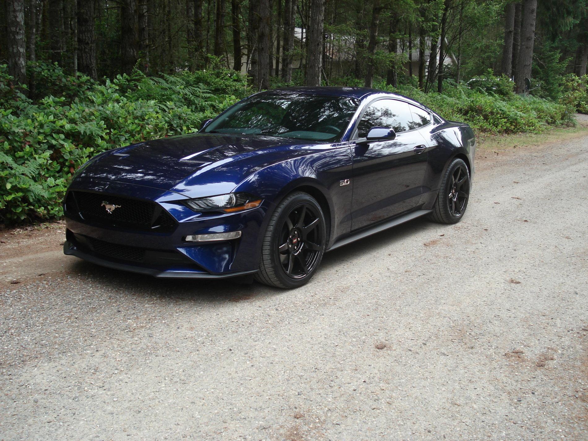

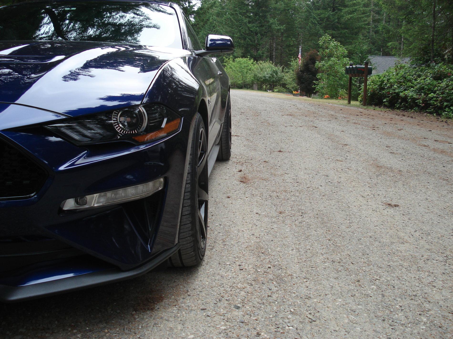

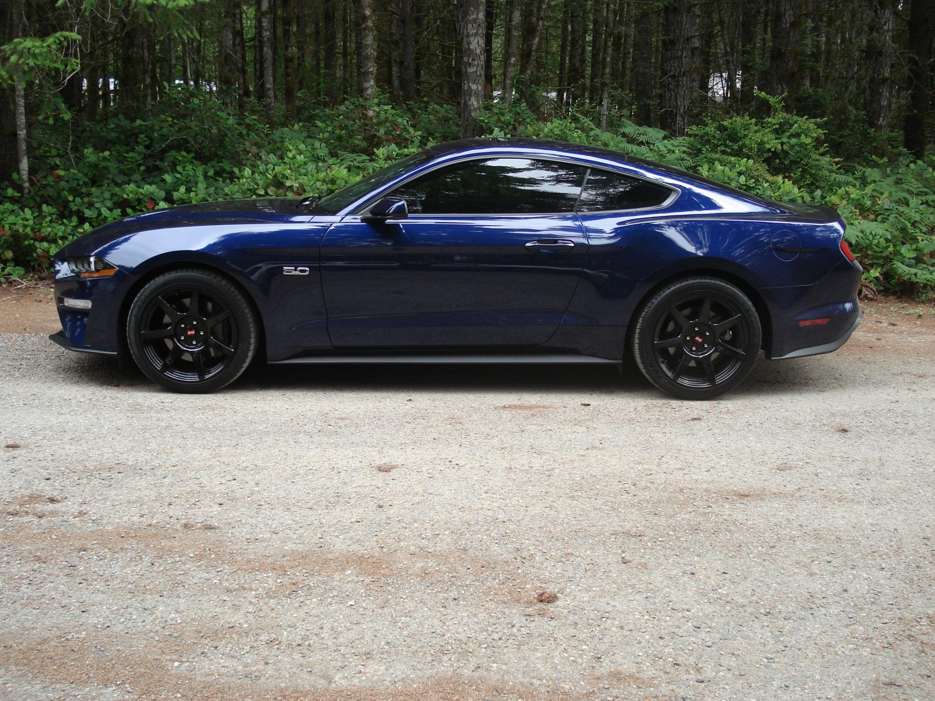

Thought I'd update this thread with my new R350's. 19x10 squared up with ATLAS Force UHP in 265/40R19. I accidentally posted this in the GT350 thread, when I actually meant it to be here. I absolutely love these new rims. They look perfect on this car, and the stance is exactly what I wanted. Now, I'm really on the fence as to whether or not to lower this beast. All I can say, is these tires are really impressive for what they are. The affordable price was enough to scare me, but the performance of them is far superior to the stock Pirelli Pzero Nero 235/50/18 tires. So, for me it was worth taking the chance.
The 265/40R19 squared is the perfect balance for a daily highway driver to give me all the handling I want, and the comfort and traction in bad weather you inevitably lose with excessively wide tires. The sidewall is larger than the 255's from the factory, yet not so bulky looking like the 275's on the PP rear. It's like a perfect size that I can't believe they don't have that many all-season options for. These tires have only 1/2" stretch, so the handling is enhanced for the 265 width, yet light enough to give it the agility I was looking for. At 25lbs for the rim and TPMS, with the tires weighing 28lbs, your looking at a 53lbs wheel that beats the stock 235 setup by a good 4 lbs each, yet more than an inch of rubber for grip. Quite impressive for my needs. Also, the 265/40 has the same diameter as the stock Pirelli's, so no need to mess with the speedometer.

Always liked that style. Looks great! I looked into that size for some of the same reasons, and was surprised at the lack of selection. I think it would work even better for my 9.5s since I prefer a little curb protection to stretch.

It is the one drawback. It does have some curb protection, but maybe 1/8" at best. It's almost a prefectly smooth transition from the rim lip to the sidewall. I can see why Porsche did this for the Cayman track cars. The slight 1/2" stretch offers that handling enhencement from an angled sidewall and utilizes every square inch of contact patch available with zero sidewall bulge. The more I look at it every day now, the more I really like it.
As if this tire was made specifically for this rim, and for this car. My car has the spoiler delete, and I really wanted to keep the look very sleek, subdued, and extremely clean. My goal was definitely accomplished.
