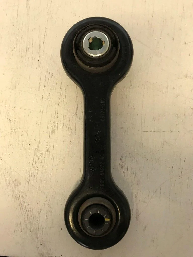

I took a picture of the backside of a stock VL and you can see that it has a good amount rubber bushing on the top side and I can stick a screwdriver through and wiggle it a bit. The bottom side has very little rubber and feels pretty solid. So my theory is that if you go with aftermarket VLs without supporting mods, you won't feel any difference because extra firmness will be observed by soft cradle bushings or as SlaughterOfTheSoul mentioned, by stock LCA bushing.

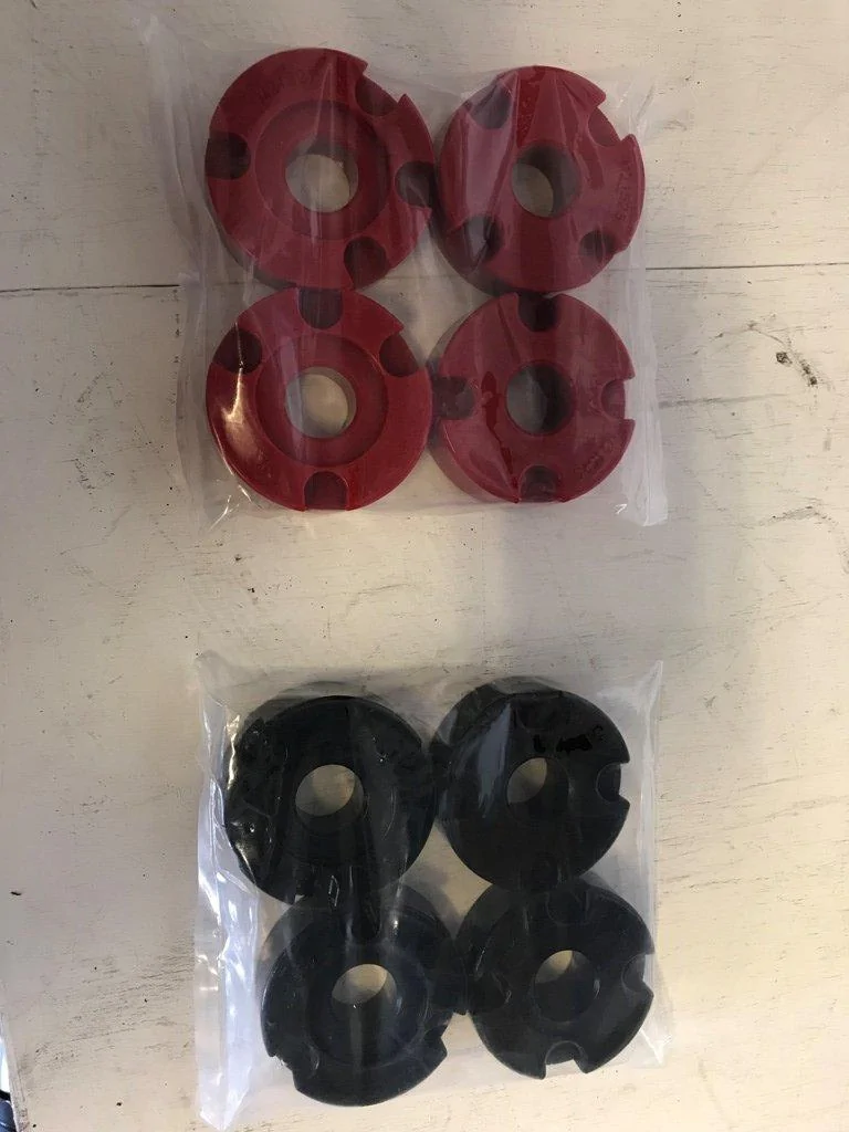

I'm not about to take of my current VLs just for comparison, but I have leftover diff insert bushings (I ended up using aluminum version as I'm willing to take a small NVH hit and diff noise for firmness). I know this isn't an apples-to-apples comparison, using an unscientific fingernail test, 80 durometer polyurethane inserts feel a bit firmer than the OEM rubber, and 90 durometer ones feel almost as hard as a rock. Not sure what's the rating for OEM rubber bushings, but this site says they generally range between 50 to 70 durometers. And since OEM rubber bushings are known to degrade over time, perhaps the biggest improvement comes from having a fresh set of bushings. I'll bet Ford race cars get their bushings refreshed often, if not between every race, unlike the street cars.
I can't comment on Steeda ones, but I think that you'll be very happy with BMR CB005. I feel that improvement from it was greater than one from the LCA bearings.
