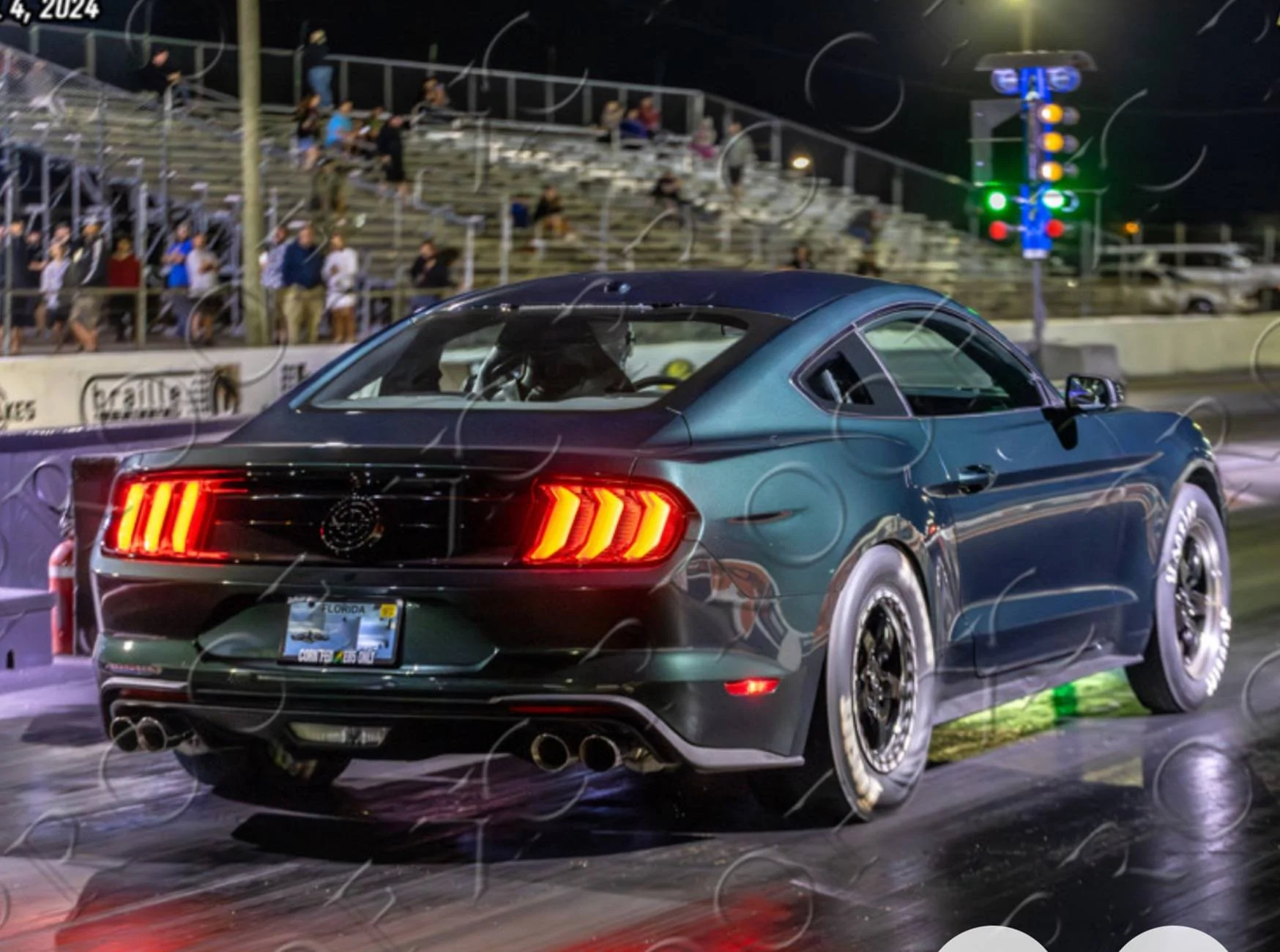

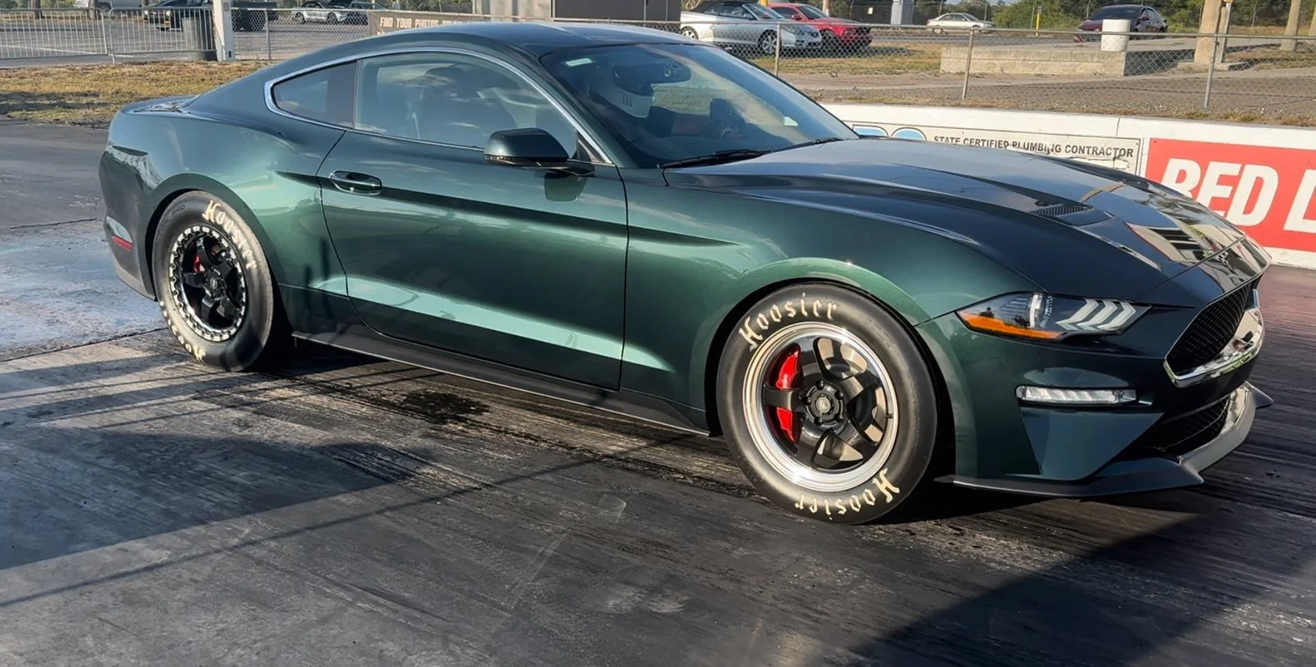

2019 Bullitt
It will work. I just installed a set of BMR rear drag springs on my car. They‘re supposed to lower the car 3/4“-1” (I believe). I didn’t want to take any chances with the tire rubbing, so I added a Steeda 1/4” spring spacer on top of the springs. Their info. says that the thickness of the spacer basically doubles what it actually is when installed on top of a spring.
