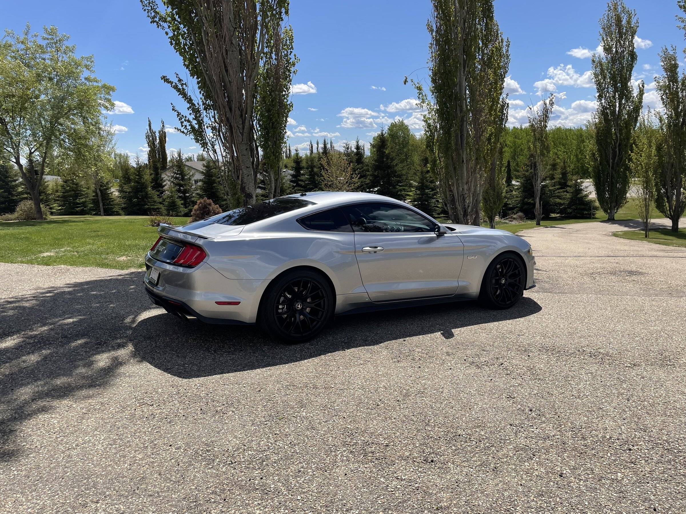

I just installed ford track handling suspension with Steeda minimum drop springs and used the spacers to bring back up a bit due my tire size. I’m running 285/35/20 square. My drop is only 1/4ā€. I love the ride quality and handling improvement.
