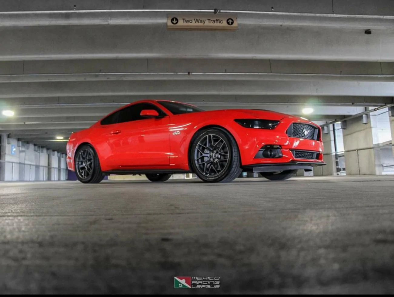

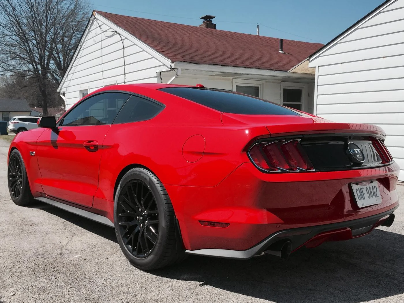

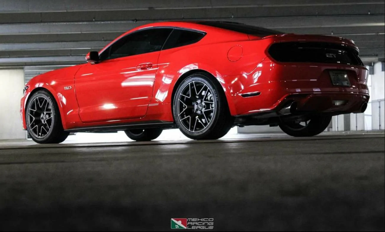

omg those wheels
TorkN8R
Jun 14, 2014
48
740
122
Northern California Bay Area
2016 Mustang GT Premium Ingot Silver Auto W/3.55's
Those are the ones...
I've also got the Steeda progressives. Wish I would have went with the sportlines for a bigger drop. I did this myself in the garage too. Never did suspension before. No creaks or rattles. No issues with speed bumps or anything. Ride is pretty solid with those 3 mods.
Wheel and tire type and size please. Those look GREAT!
Shouldhavegotthegt
Oct 13, 2015
966
285
Phoenix
2016 Magnetic GT 2014 Ram 1500 RCSB 4x4
MMD Holgens 20x10 all the way around with 275/35 Nitto N555 G2s. I just 5mm spacers all the way around too. Haven't taken any recent pics
