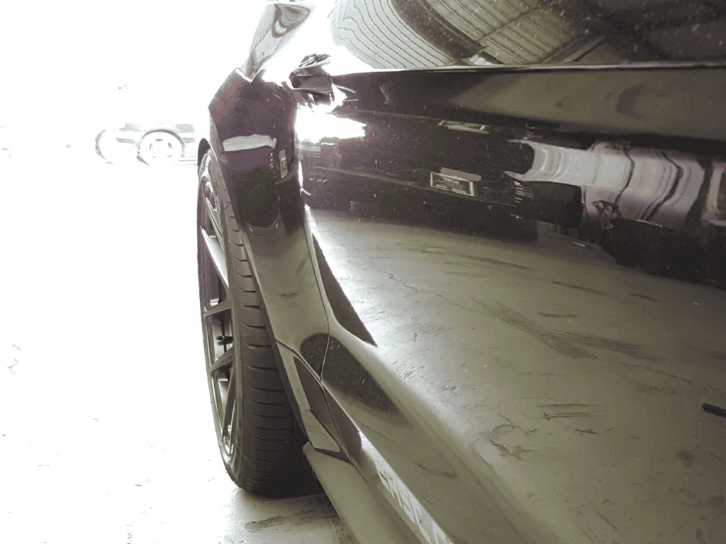

Hey unless you put well extensions you are going to have wheel poke with 325's. I have 315's on 11" rims and they are just clearing by a whisker. So I am sure you wont be able to lower it any because with mine when lowered you can only just slip your little finger between quarter panel and tyre.
This is my tyre on a 1" lowered setup:

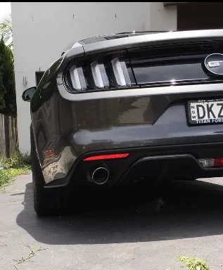

I'd be avoiding a Michelin in that rear width, on those wheels, like the plague mate.
Michelins are renowned for being a wider fit than most tyres on the market.
A mate of mine is running 305 MPSS on his 6Gr's and they DO poke!
The amount of added negative camber you'd require would be crazy.
Your money, just saying. :cheers:

6Gr 11" wheel with MPSS 305, standard height and camber.
Are those MPSS? I'm getting the track performance pack which includes lowering springs.
OK it seems 325 is not feasible then. The guy from Need4Speed Motors assured me they'd fit and has shown pics of that setup, but they weren't running MPSS admittedly.
So 305 or 315 at the rear? Comments welcome.

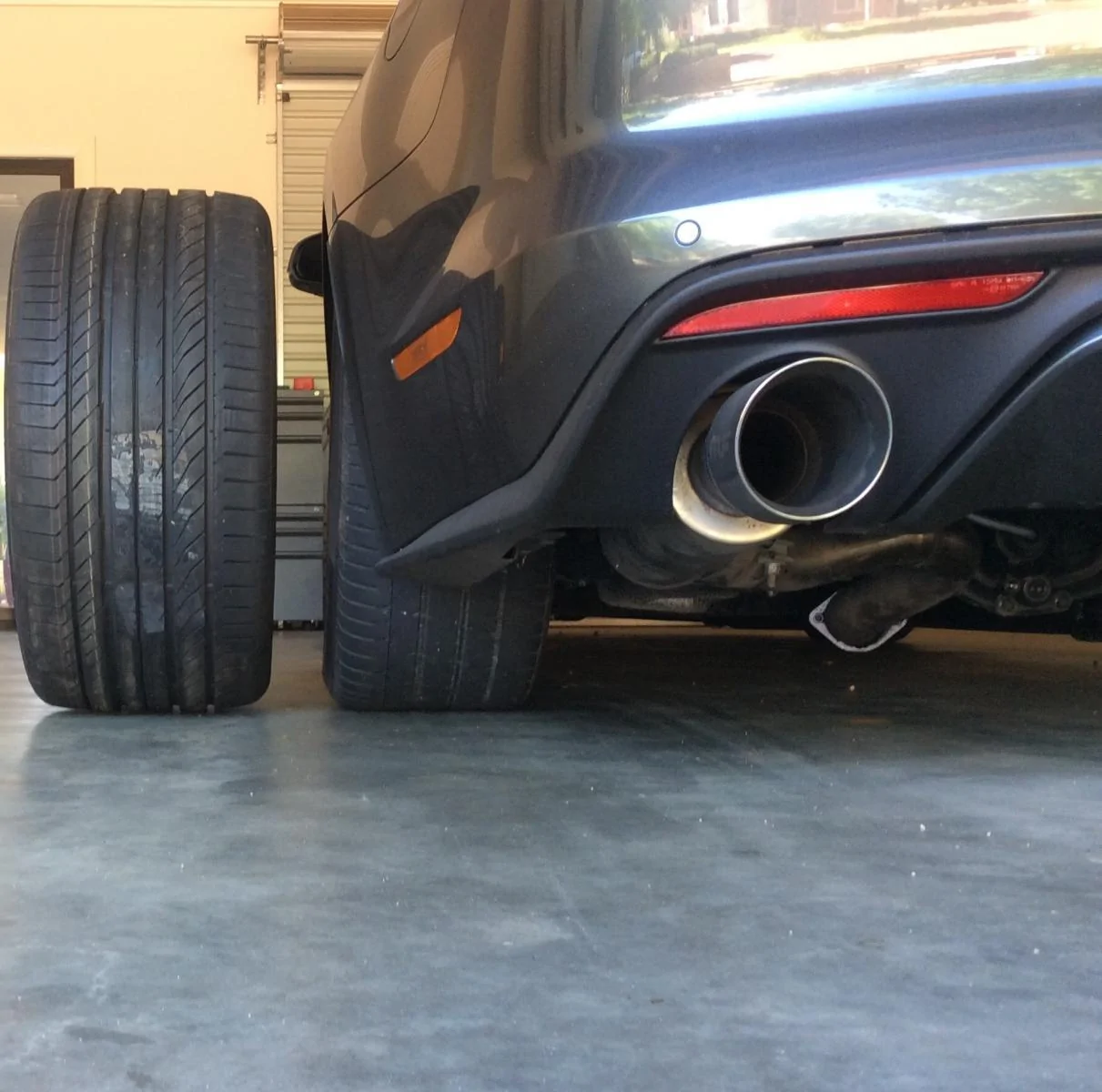

Hi Burkey totally agree with your comment to disregard anything coming out of the USA with regard to fitment.
We are importing 6GR wheels and will be the distributors for Australia. So correct fitment becomes our issue.
In the meantime we have a set going on our own GT this week and will be fitting 295/35/20 Conti rears on 20x11.
We have tried 315s Nitto's however they POKE and the Michies will poke even more. Apart from the fact it is illegal and u stand a high chance of getting a ticket as it is so visual.
We did Alan Goldmans a couple of weeks ago and he totally agreed so he then went to a 295 rear clearance problem solved!
Remember the 20x11 only has a 50mm offset. You really need closer to 60mm for it to be a real nice fit with a 315.
Your other choice is to alter the camber and pull that wheel right in at the top. You will then start excessive wear on the insides of your tyres.
Its a tough one!
Cheers Fred

You will scrape if its lowered and you have a 315
The boys at Need4Speed told us the same thing that clearance is good, like no its not we have tried it here and I relayed back to them, the reply was Oh maybe not if its lowered so we had a two hour conversation about it.
The long and the short is fit a 295 rear and this will give you some clearance.
Sorry, I made a typo, its 305's on mine not 315's. I just realised when I jumped back on and seen my post!
