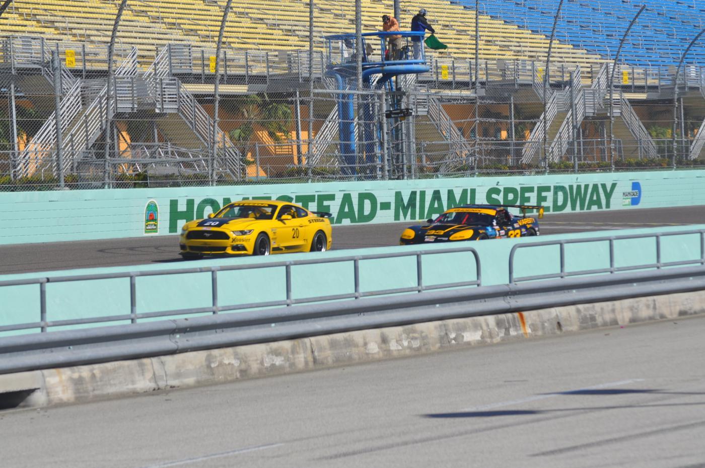

Nice! I want the hi-def version of that and I'm gonna have it made into a canvas! Looks like the Steeda car is balls deep into the gas pedal scootin' past that Corvette.
If you want to test it out at AMP, I'm happy to be your driver. :cool: Just lemme know? :shrug::crazy::headbonk::lol:

If you want to test it out at AMP, I'm happy to be your driver. :cool: Just lemme know? :shrug::crazy::headbonk::lol:[/QUOTE]
Hey, doesn't hurt to ask, the worst they could do is say no. :shrug:
(I bet you would sh*t bricks if they said yes).
