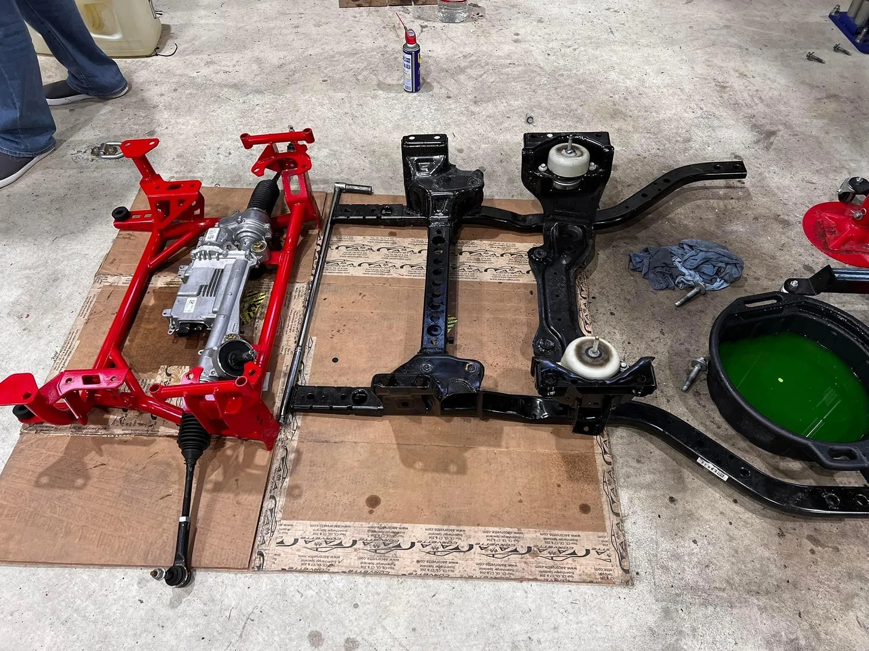

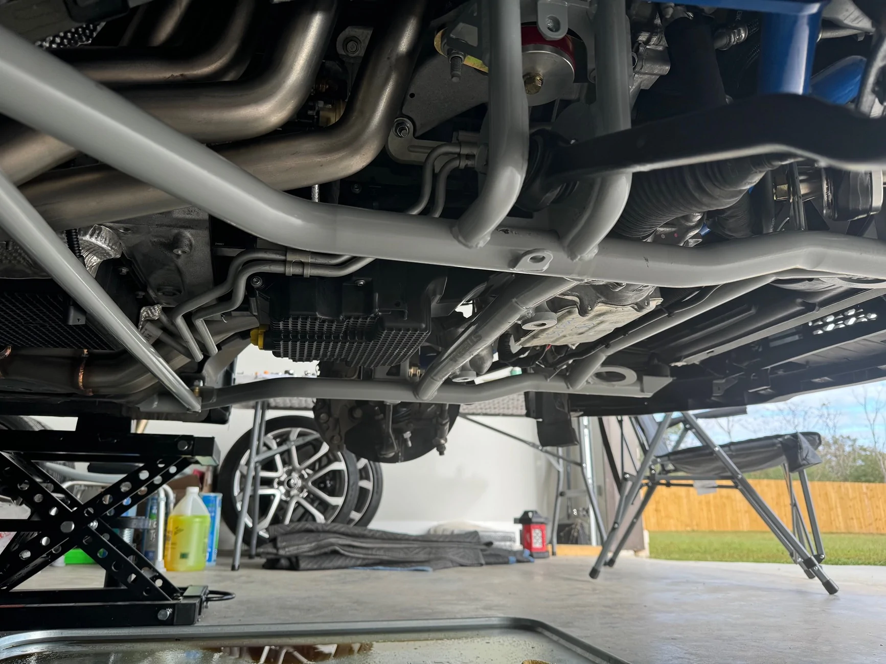

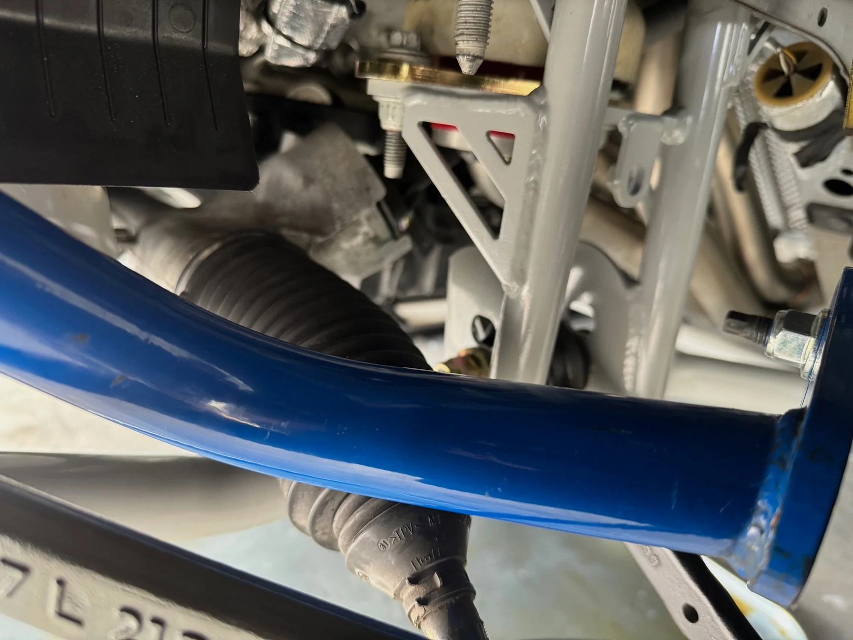

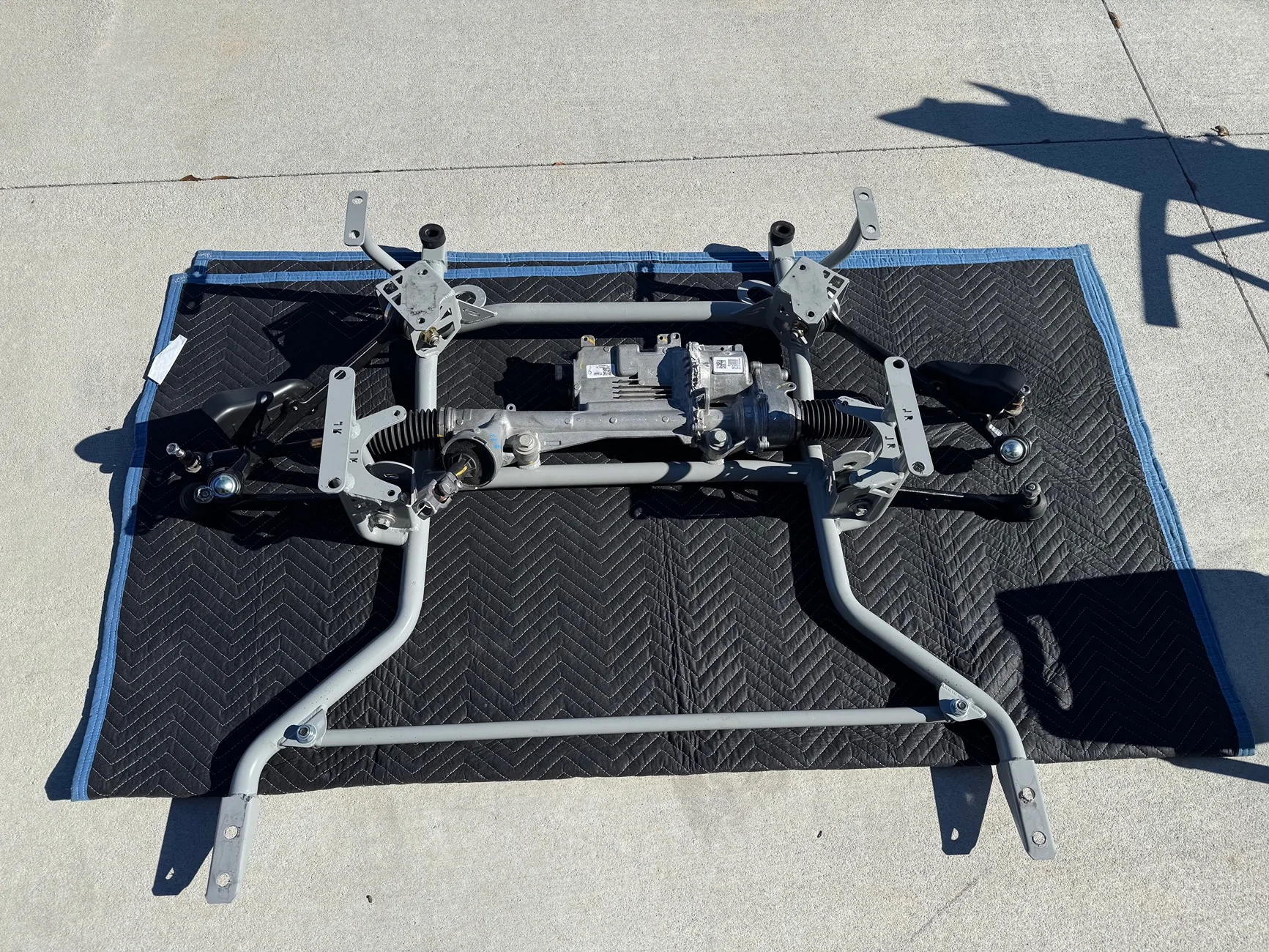

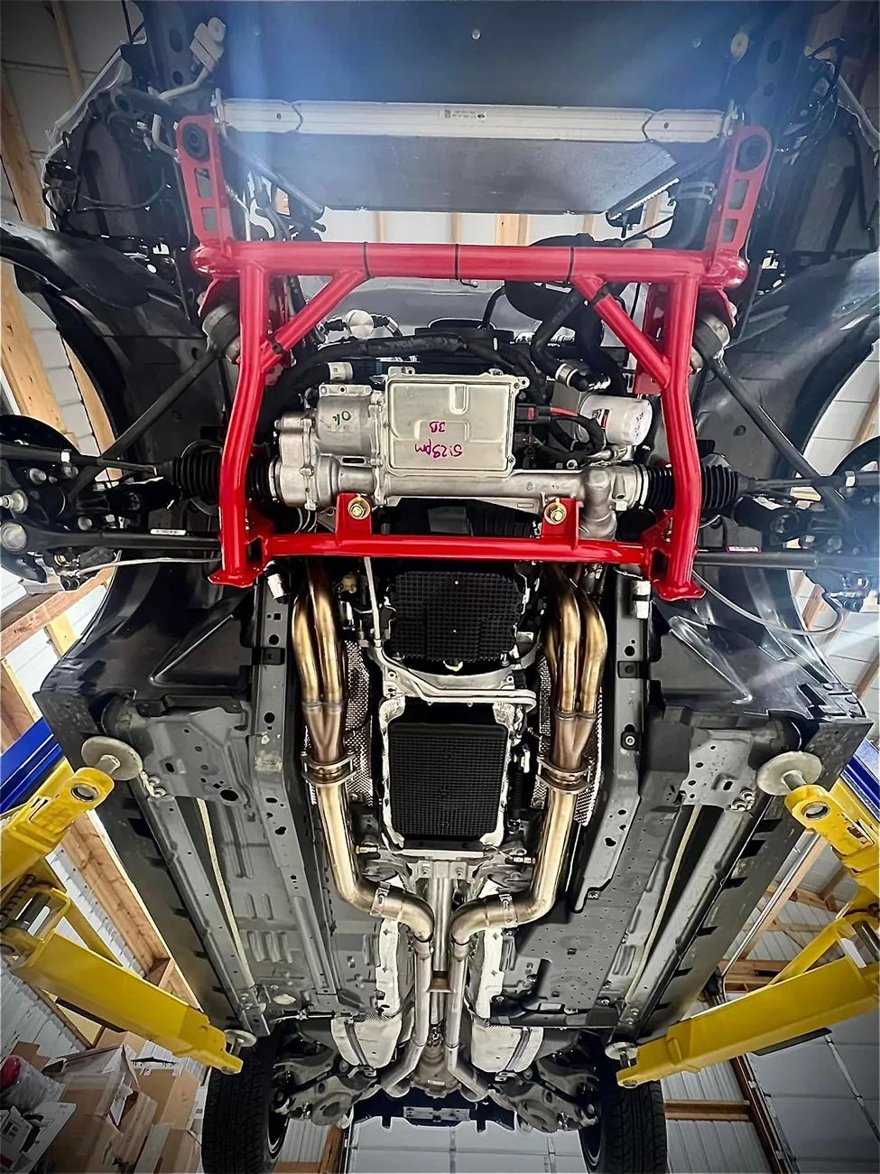

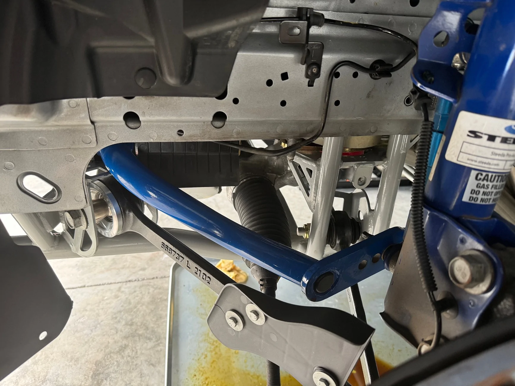

I'm running the Steeda and couldn't be more pleased over the OEM K Member. The car handles completely different.
