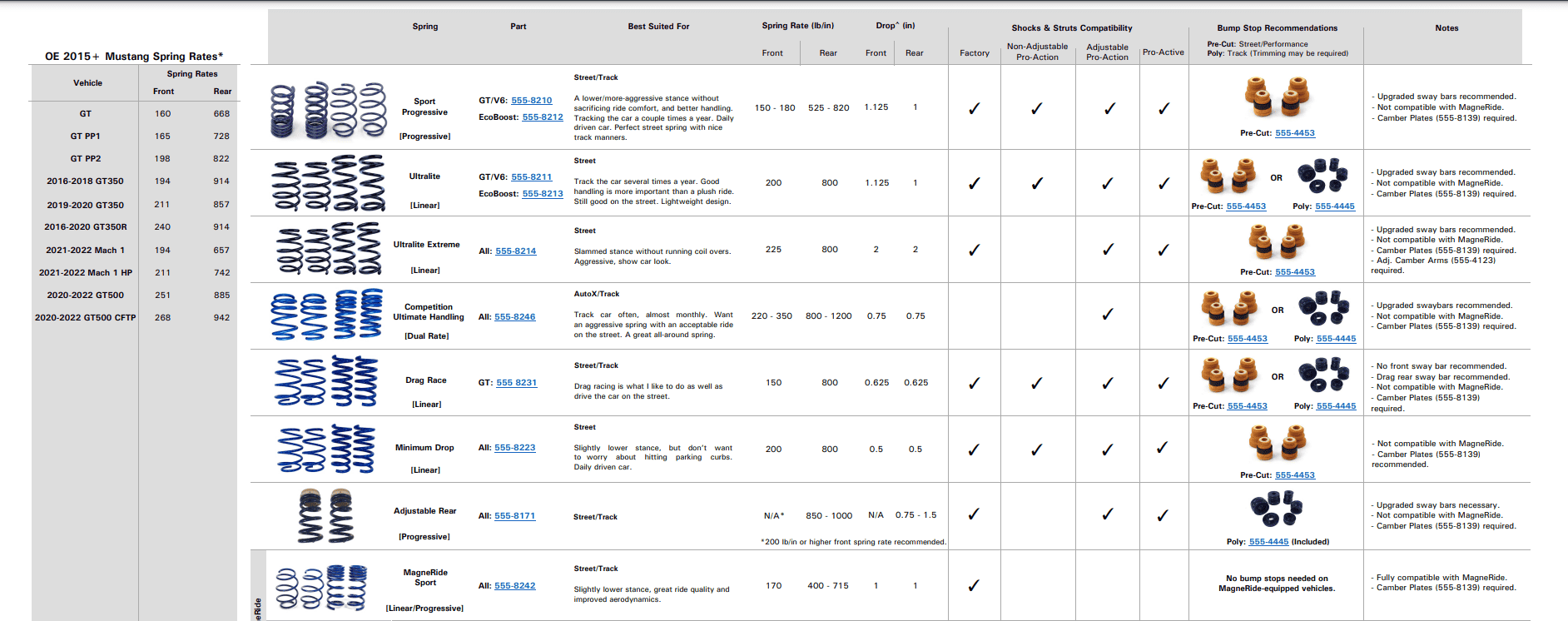

I will let others weigh in regarding your question above but this may aid you in your questions:
Here is a screengrab of our spring guide that can be found on our site with some other details here:
https://www.steeda.com/s550-mustang-spring-guide

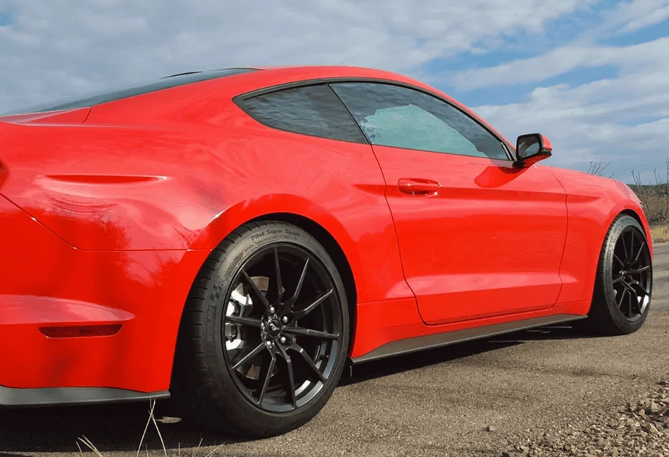

Hey @GregO do you happen to have a picture of your car? For some reason there’s not a ton of pictures of cars on ultralites.
It sits near perfectly level front to rear @ 27” from ground to apex of wheel well with full tank of fuel and spare tire.

We have a few online ...

Thanks TJ, I’ve seen these on your site along with a few other customer cars. I would of thought I would of seen more pictures on this forum but guess not.
