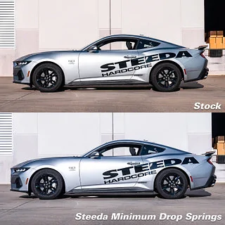

555-8223 Minimum Drop Springs
Minimum Drop Springs are for those who want just a hint of drop. If you’re after a factory-plus look and want to keep ride quality and clearance in check, these springs deliver subtle improvements without going overboard.
Specifications
  • Lowers S550 0.5" front and rear
  • Spring Rate:
    • Front: 200 lb/in
    • Rear: 800 lb/in
Best For
  • Daily drivers
  • Areas with rough roads
  • Owners who are concerned about scraping
  • Drivers wanting a factory-plus appearance
What to Expect
  • Slightly improved handling
  • Minimal impact on ride quality
  • Reduced wheel gap without an aggressive drop
  • Excellent option for owners wanting subtle improvements
