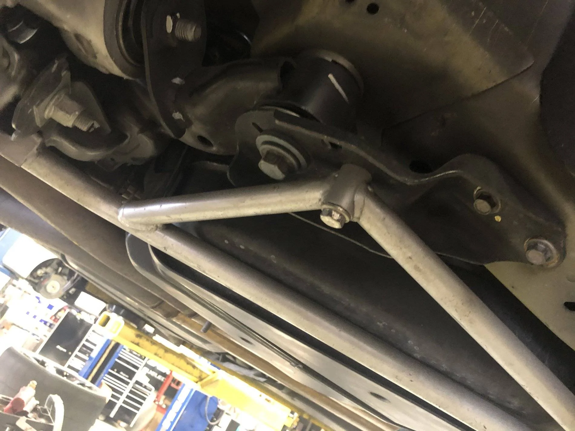

The Stop hop starter kit is a great start to keep the rear sub-frame on center and to control IRS movement. The Kit includes our IRS sub-frame brace,Alignment dowels and IRS support bushings.
Great start to having a great foundation! Picture below of our #20 car with the same components being prepped for the next endurance race which we are leading in points!
