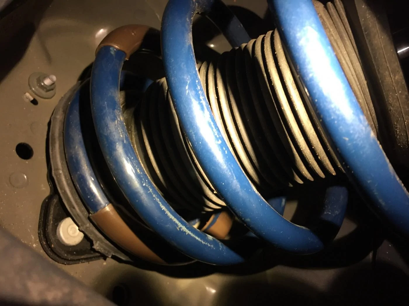

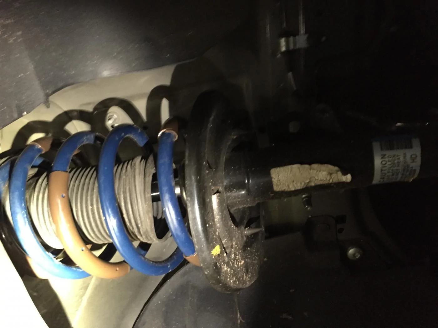

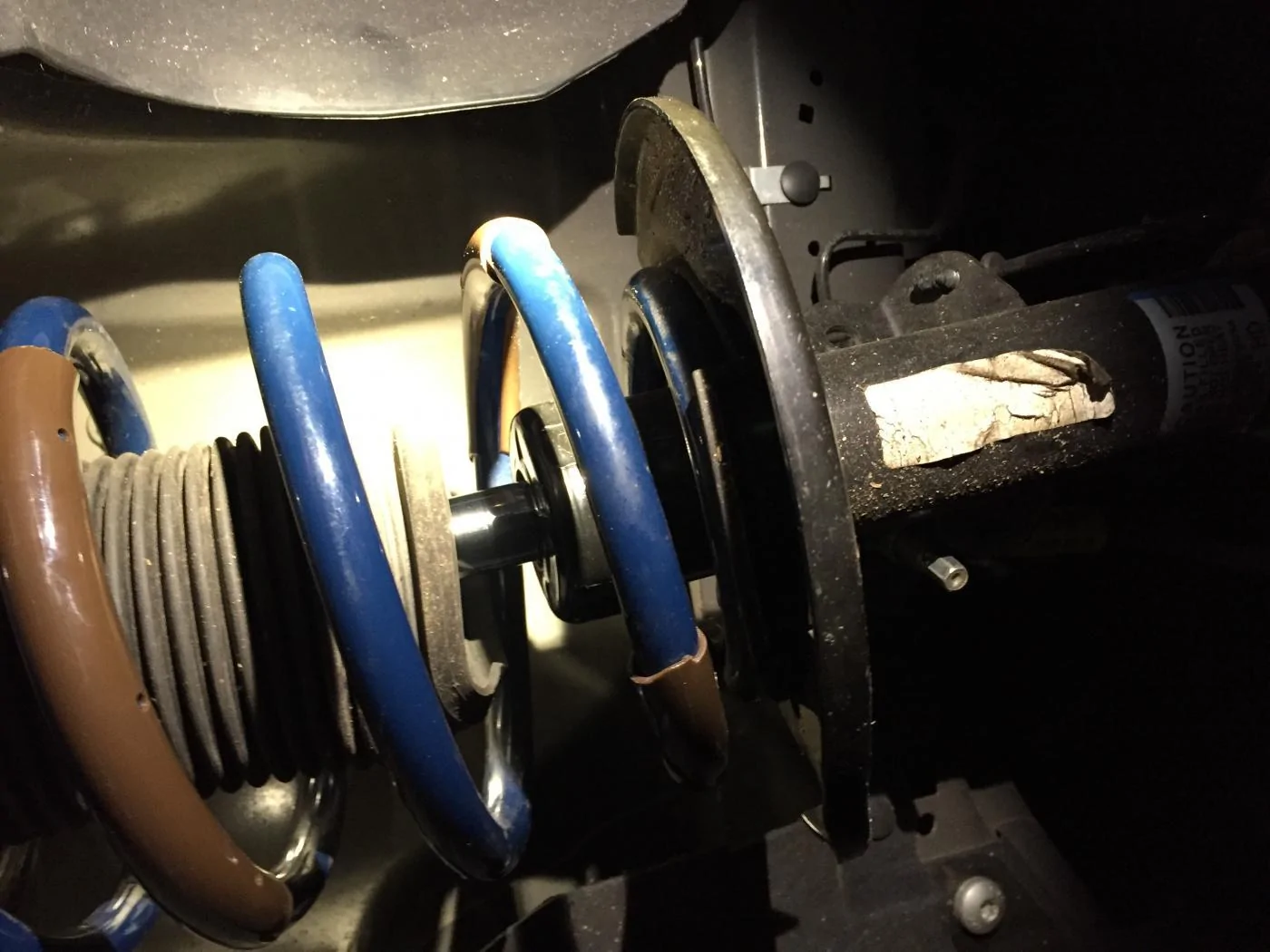

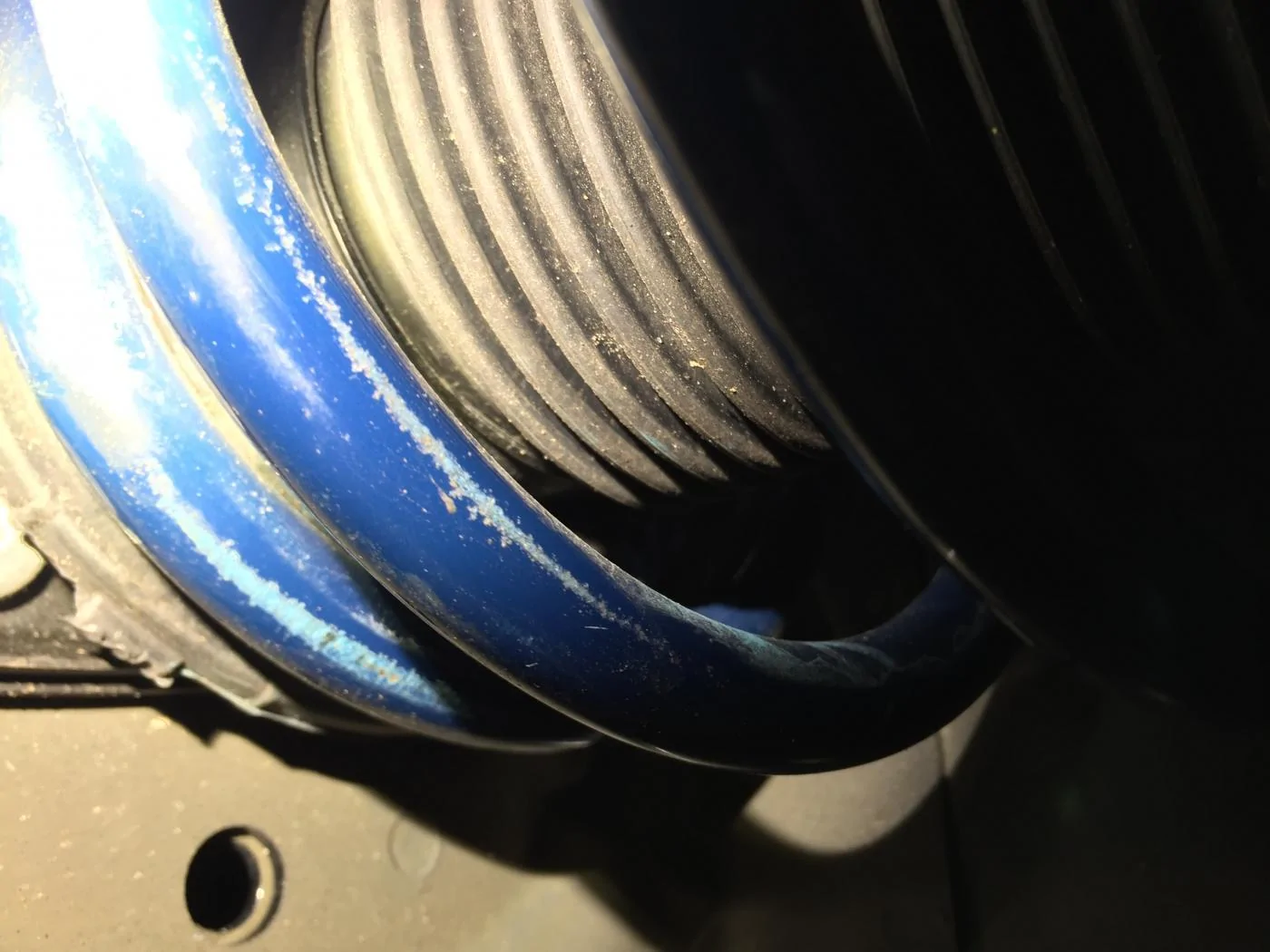

Guys I fixed it! 100% no noise now. I tried tightening the strut nut on top and checked the end link nuts(they were tight). Still had noise. The springs were touching when hitting bumps. I bought some Tein silencers and put them on the springs and the noise is gone. It can be done with the springs still on the car. Just look at the spring for any wear marks and move your hand along the whole thing to feel for any wear. Make sure you don't put 2 silencers above and below each other. I used a silencer at the top of the spring and cut another into smaller pieces and placed them where I saw wear marks. Tein silencers. $5 a pair. Get a pair for each side(even tho only my passenger side clunked). I see some people had noise on drivers side and some people had none. I guess everyone's car is different as far as weight. Also make sure to order the large diameter silencers(130mm). I will also post a few pics.

I also want to say I don't believe this is an issue with steedas quality at all. I love how the car looks with the springs and the ride. I think it's just the nature of progressive springs.

sorry about the pics lol. Im not good with computers
