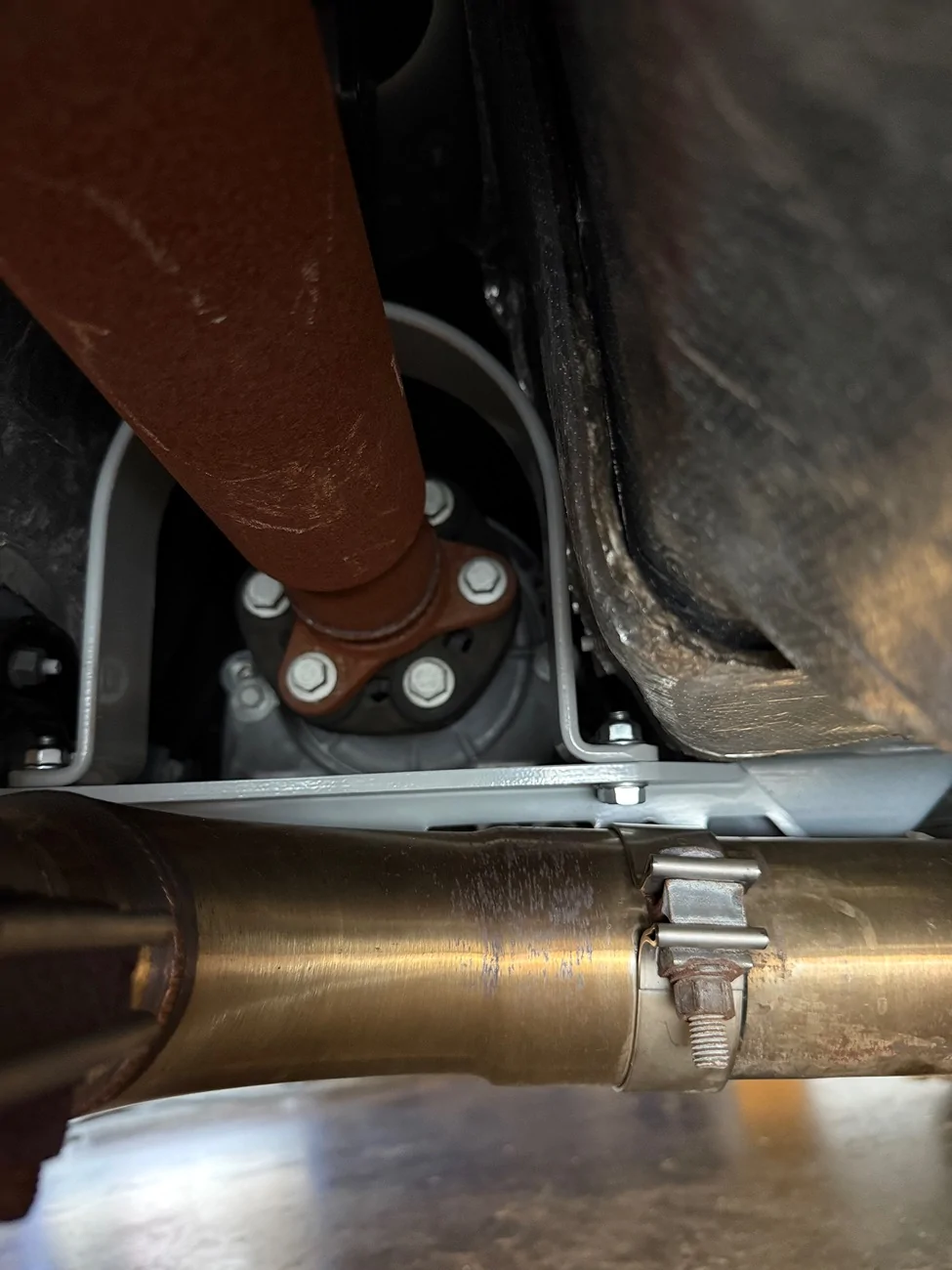

Those who wondered if the Steeda NHRA legal driveshaft loop would fit the Ecoboost with the 10 speed automatic, yes it will, it is a tight fit getting to the bolts to tighten them but if can be done in about 30 minutes. The exhaust hanger bolts to the tunnel on the left side and at first you think there is no way it will fit but just work at it and when everything is tightened up it fits fine. Just be patient while aligning everything up and know that it will fit.

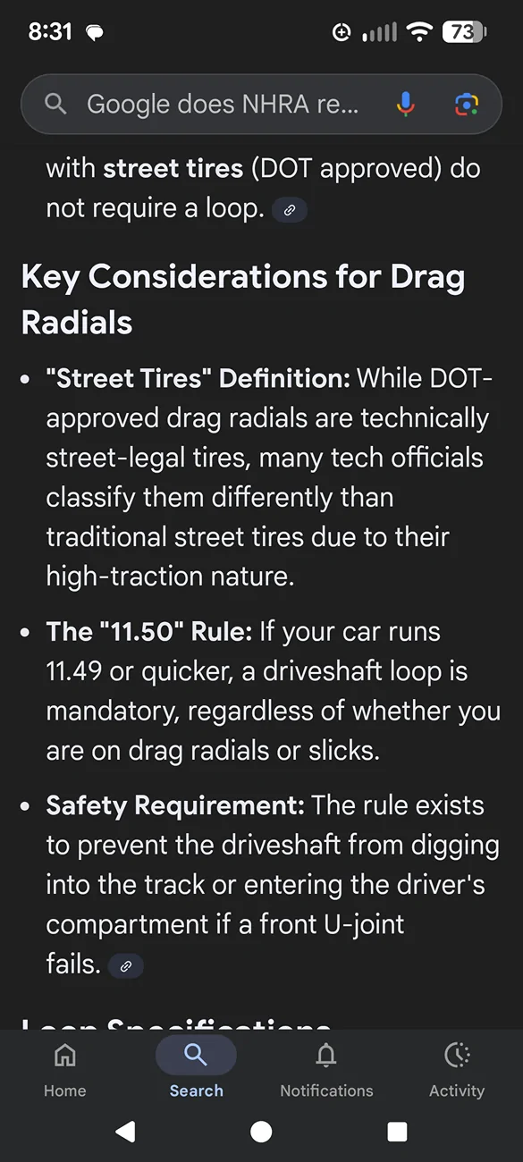

Maybe I should of elaborated a little more, when I was Drag Racing, running slicks (at that time non DOT ) NHRA requires a front drive shaft loop , and recommend a rear drive shaft loop for added protection. In my 27 years Racing I've seen a few u joints let go , most serious racers know and run solid high strength u joints and rearly have seen failure . A suggestion to Drag Radials users I would install at the minimum a front loop , and most Tracks Tech requires on DOT Drag Radials or ETStreet as these tires are made of high traction compounds .
