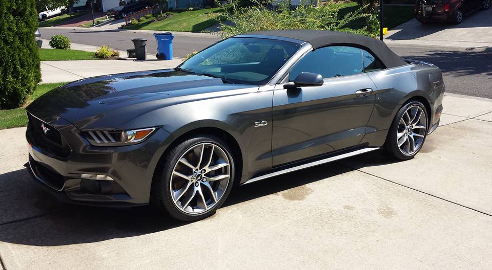

Im in the process of getting a quote for springs. I found a good Mustang only shop in my area. I had originally wanted Eibach but they suggest Steeda and since I see them talked about a lot here (including having a rep) I figured why not.
What should I get on my Mustang convert with the OEM 20's that will fit the best? I want performance over looks. I don't mind stiffness, the Stang is not much of a daily driver (I drive my 2004 Honda Civic). I'd like to hit some autoX and track (circuit) with it casually. Obviously I dont want the 20's to rub, I'd like to replace the rubbers with wider tires when they burn out (265 now, hopefully 285 later in the rear kinda thing)
Whats the real dif between progressive and linear?
