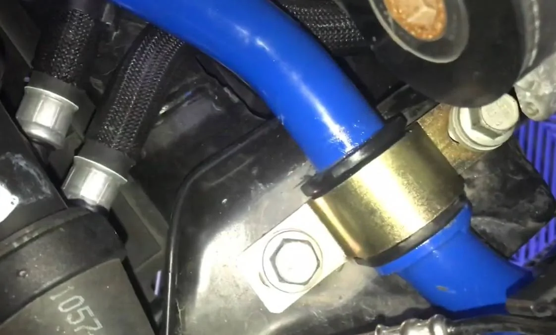

Okay how did you tighten down the driver's side bolt under the alternator?

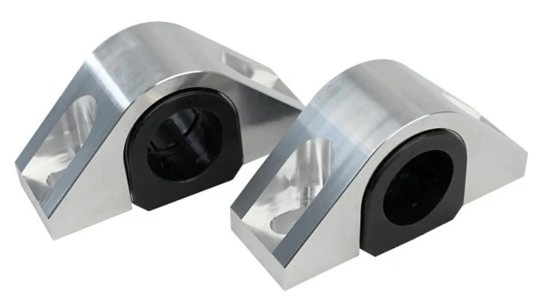

Calvin Active Member Joined Oct 13, 2016 Threads 5 Messages 42 Reaction score 26 Location California Vehicle(s) 17 GT PP Jun 23, 2020 #2 Two ways. Knock out the allen portion on the correct sized allen socket and use that with a cresent wrench. Or cut a section off an allen wrench and use the corresponding cresent wrench to tighten it.
OP OP Bahndvr Roushcharged Joined Jul 4, 2014 Threads 185 Messages 1,504 Reaction score 220 Location Germany Vehicle(s) '16 Roush Warrior Mustang Vehicle Showcase 1 Jun 23, 2020 Thread starter #3 No allen bolt just a standard bolt This is not my engine bay, just using to show you the bolt head
OP OP Bahndvr Roushcharged Joined Jul 4, 2014 Threads 185 Messages 1,504 Reaction score 220 Location Germany Vehicle(s) '16 Roush Warrior Mustang Vehicle Showcase 1 Jun 23, 2020 Thread starter #4 Thanks to @WhiteyDog I've order an 18mm low profile swivel socket.
OP OP Bahndvr Roushcharged Joined Jul 4, 2014 Threads 185 Messages 1,504 Reaction score 220 Location Germany Vehicle(s) '16 Roush Warrior Mustang Vehicle Showcase 1 Jun 23, 2020 Thread starter #5 It's impossible to get a ratcheting wrench in the bolt valley of the billet mounts, I tried. I used an offset box end to get it tight Last edited: Jun 23, 2020
Calvin Active Member Joined Oct 13, 2016 Threads 5 Messages 42 Reaction score 26 Location California Vehicle(s) 17 GT PP Jun 23, 2020 #6 Ohh ok. Yeah my Steeda billet mounts came with allen heads so just assumed.
