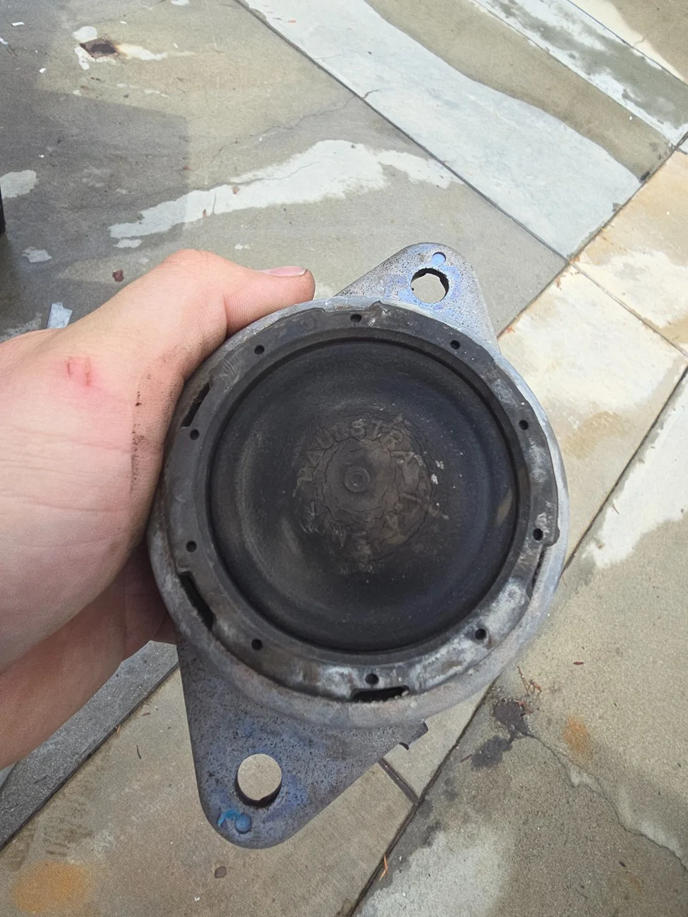

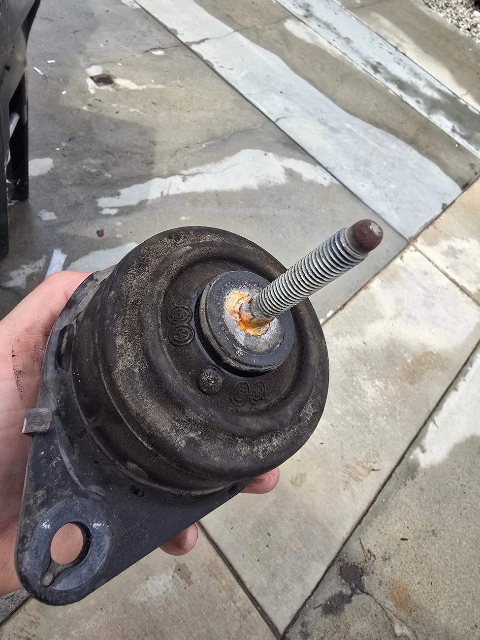

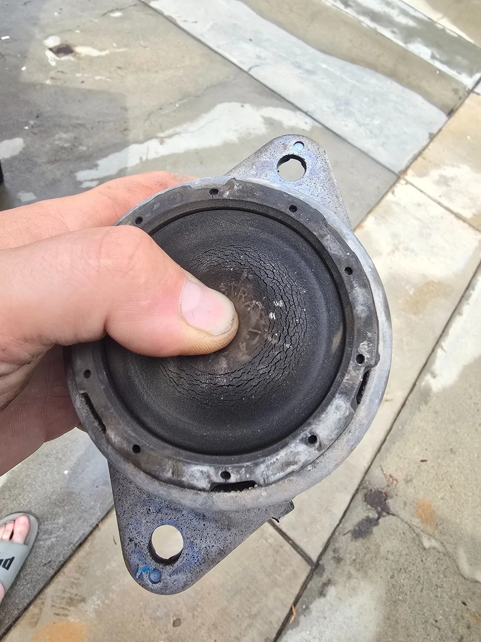

No pictures unfortunately but I just installed these mounts today to replace my old ones that I thought were shot (they've got 84k miles on them and I was experiencing alot of tramlining and jerkyness when shifting) but I thought wrong. Oh well.
Anyway, first of all the mounts are absolutely worth the money. Shifting is much more buttery, less jerky, turn in is more responsive, no more tram lining, doesnt feel like engine is shifting left or right when turning, and when I hit the gas it feels like the car and engine are actually attached to each other now instead of the engine just "sitting" in the car. Can not recommend them enough. It's a cheap price to pay for something that makes the car feel much more expensive and well made.
