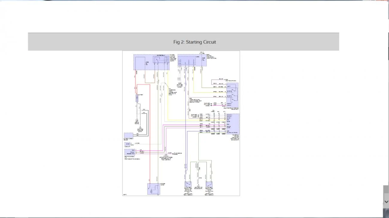

Next issue, chased down a wiring diagram of the starting circuit. There are two clutch pedal switches, one you can see and one you can't...yep the one you can't was the culprit.

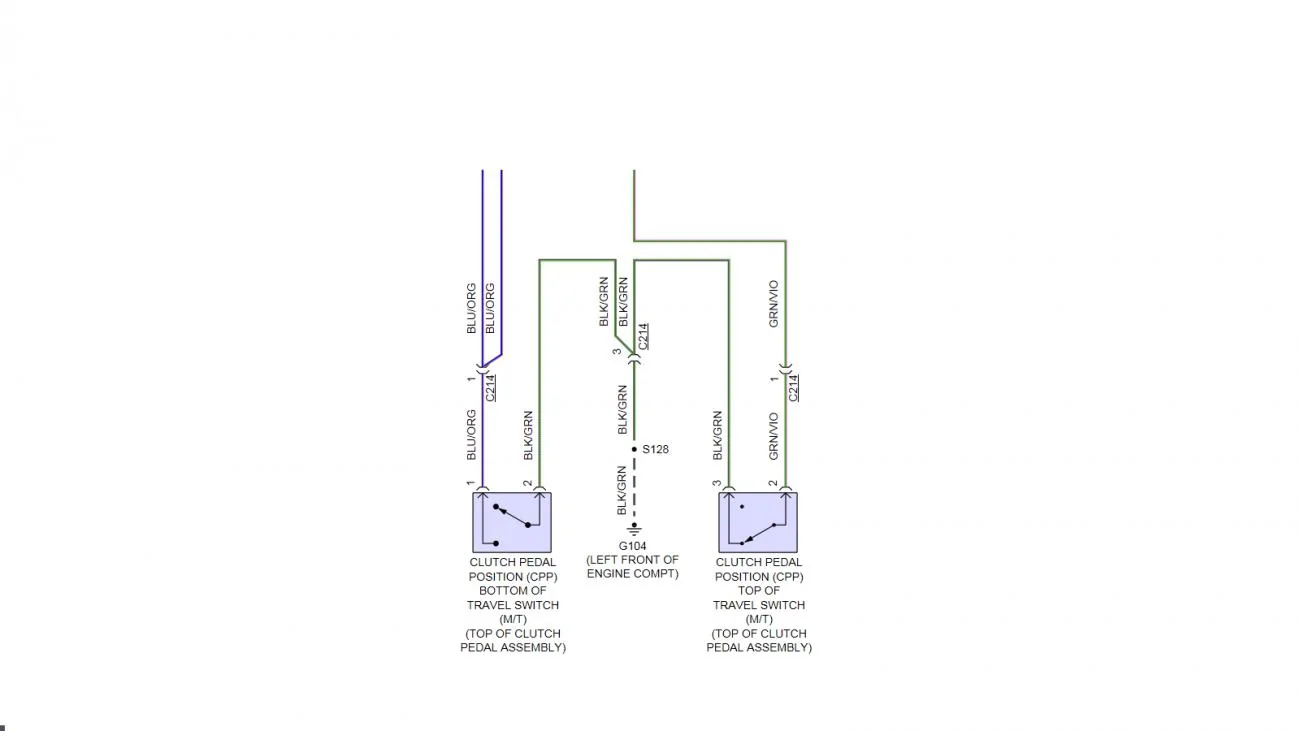

Here is the starting circuit...horrible resolution ...sorry.
also the clutch pedal sequence for others.
