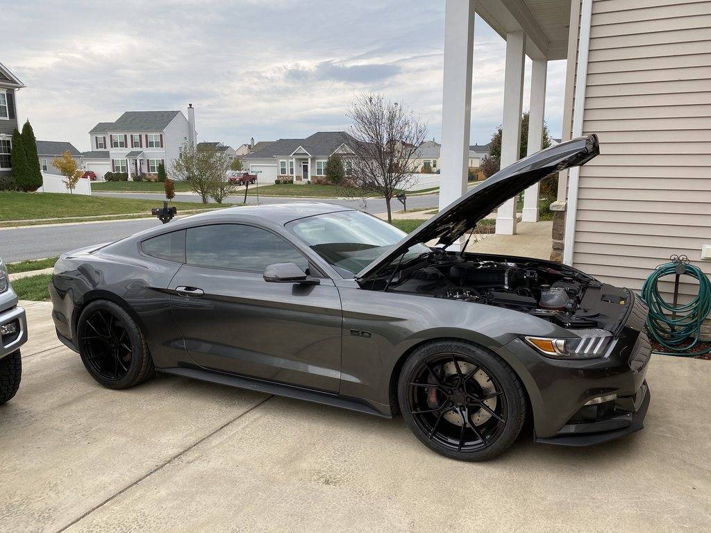

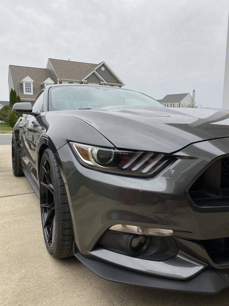

Here are my SF07's for some reference
20x10 +35
20x11 +50

Yea, everything cleared easy. The fronts are reaaaaaal tight on the hubs, takes a little effort to get the on and off. But they clear just enough with no spacers.
Tires are 275/35 and 315/35 Conti Extreme Contact DW.

I probably wouldn't do any tighter (higher) than a +35. I think a +40 would get close to rubbing, if not already hit. I have no rubbing with these wheels, they've been great.
