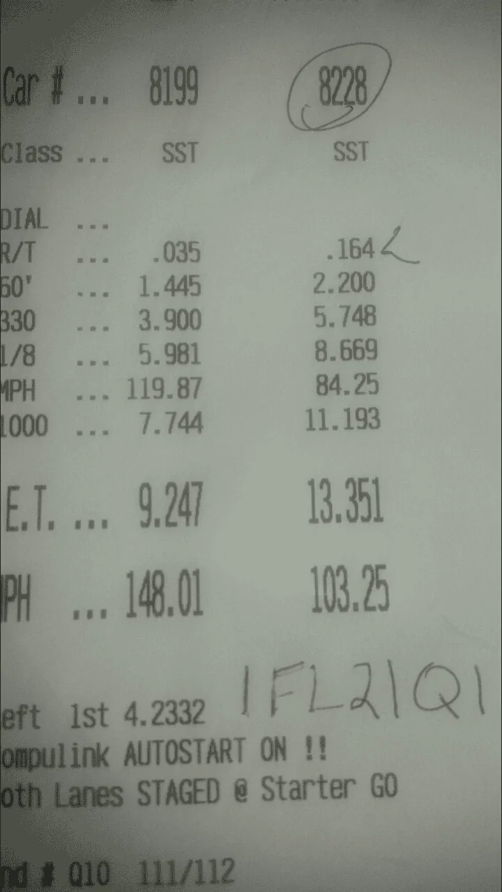

You need to put the converter in and then get back at it. Then work on the suspension settings. Launching at 3300rpms is gonna take different setting. You should be cutting 1.5x to 1.4x 60’ easy then.

I ran in the opposite lane of one of those 1.4 to 1.5 cars at the NMRA Spring Break Shoot Out...
...crazy fast!!

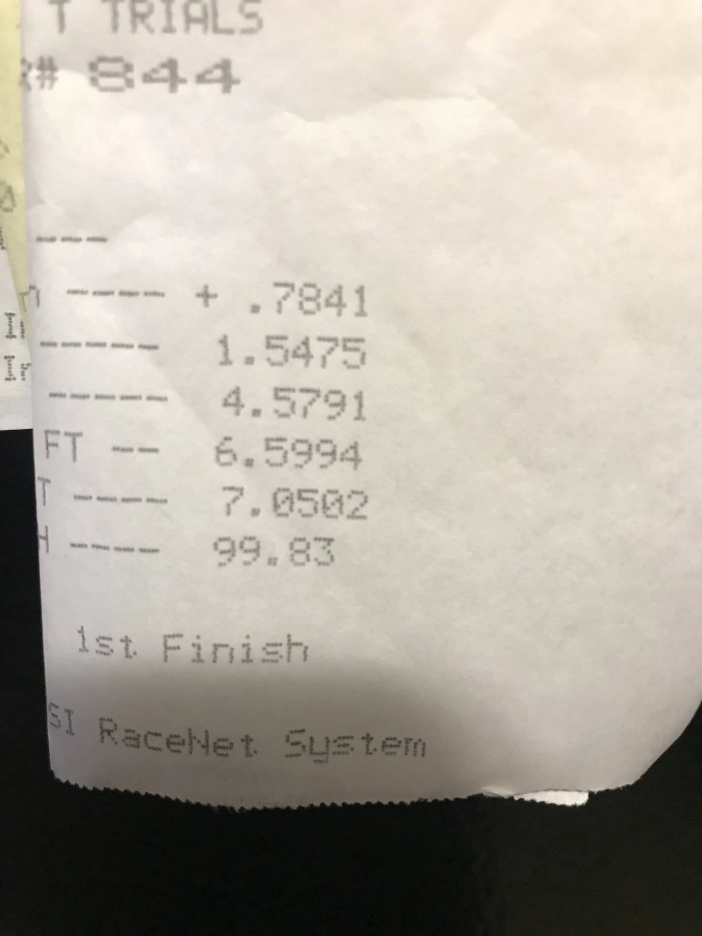

Just got the converter put in for those who are following... sorry for the delay
Car stalls to about 3400 on a street tire on plane Jane asphalt. Hopefully going to the track Friday to make some test hits and start to dial in the tune with them.

First track day with the converter, defiantly needs some getting used to and tuning help. I lost a lot on the top end but improved my 60ft. Fastest pass was a 7.30. Best 60ft was a 1.5, and fastest et was 93....
