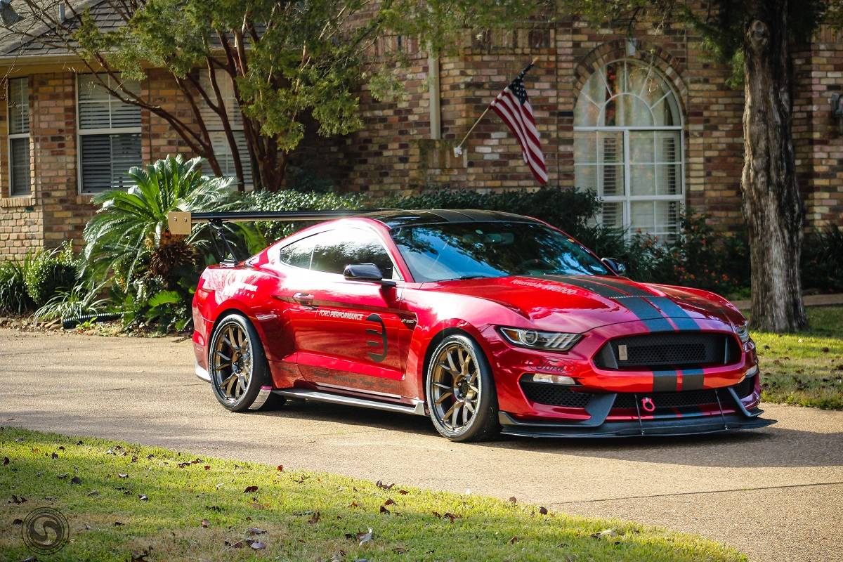

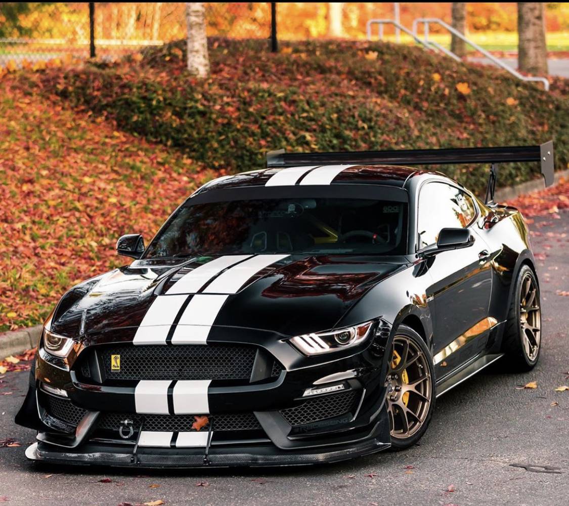

Wheel selection in terms of square and square rotatable really comes down to your end goals with the car. The square rotatable 19x11 setups we build at Signature Wheel require longer front studs and a 25mm or more front spacer depending on the camber you run, or how aggressive you want the front wheel track to be. Paired with a 305/30/19 you end up with a 20lb wheel that can go to war. Not to mention the anti-slip bead knurling we can add in.

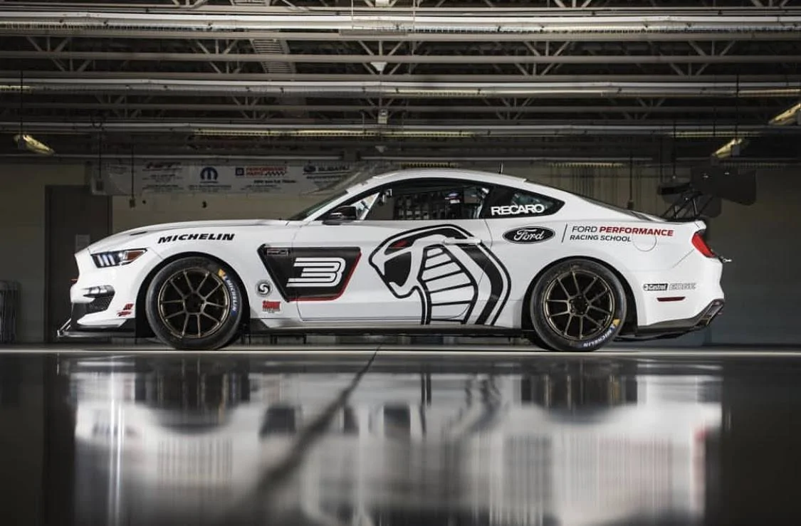

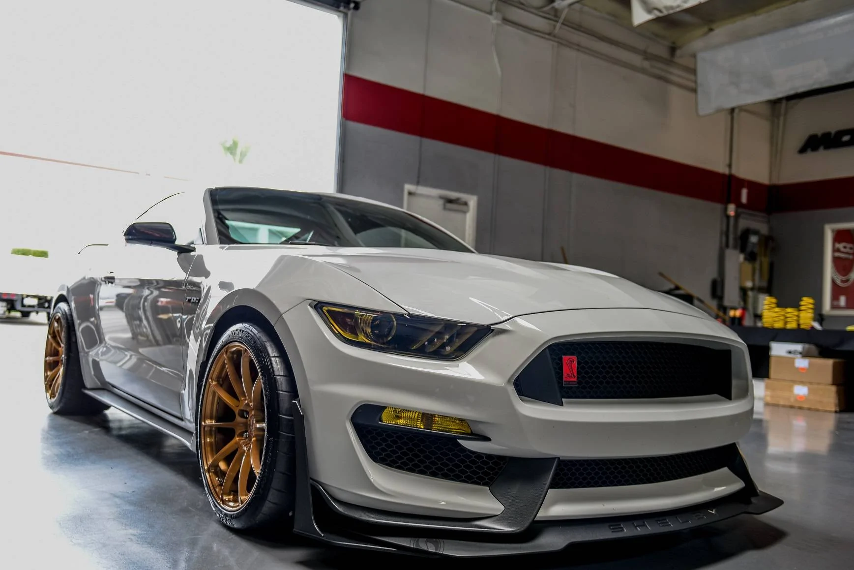

We also developed 19x11 or 19x11.5 square non-rotatable setups that bolt directly on to the front and rear of the car. No spacers or specialty lug nuts needed, but we developed titanium lug nuts to fit the need. This only allows you to swap the wheels/tires side to side, but you definitely increase the amount of front grip you can get out of the car. On the 19x11.5 square you can use a 315/30/19 SC2 at all four corners. The car is going to feel extremely planted. Generally these setups come in at 20-23 lbs depending on the wheel design.

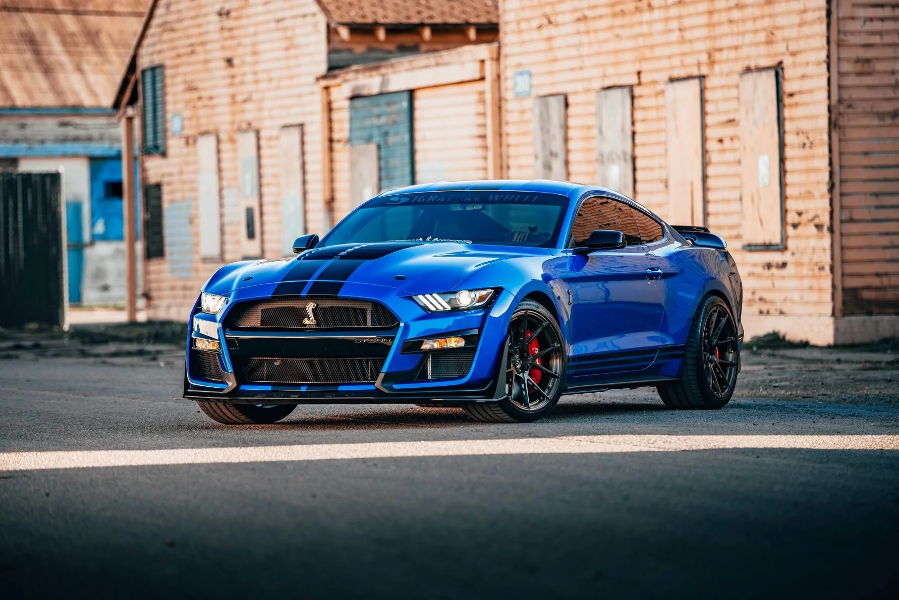

With the GT500 we are building 20x11.5 square that uses a 315/30/20 and it feels so damn good.

You had to hit me with the exact color of the car and wheels I was looking for right up at the top. She looks amazing, too. Exactly how I envisioned it.
You say the 19x11.5 you offer is a direct fitment without spacers for a square set up? I do not mind that I cannot rotate and swap around. So long as I can buy 4 of the same tires all in the same size. A weird issue since Michelin is apparently phasing out the Super Sport... and possibly the 4s? The former I knew about. The latter was interesting to find that no one in the area could get a hold of a 295/35-19 (or was it the 295/30-19? I can't remember.)
If the 19x11.5 is a direct fitment and more aggressive, then I'm definitely interested in that. A little poke is fine with me if it happens. Interchangeability of wheel placement is not a concern.

The 19x11.5 we can build with or without poke. Depending on the amount of camber you plan to run I can adjust the offsets based on what the final form of the car will be.
The latest I have is more tires will be available in March/April. But the 315-30-19 SC2 should be attainable without much fuss.
