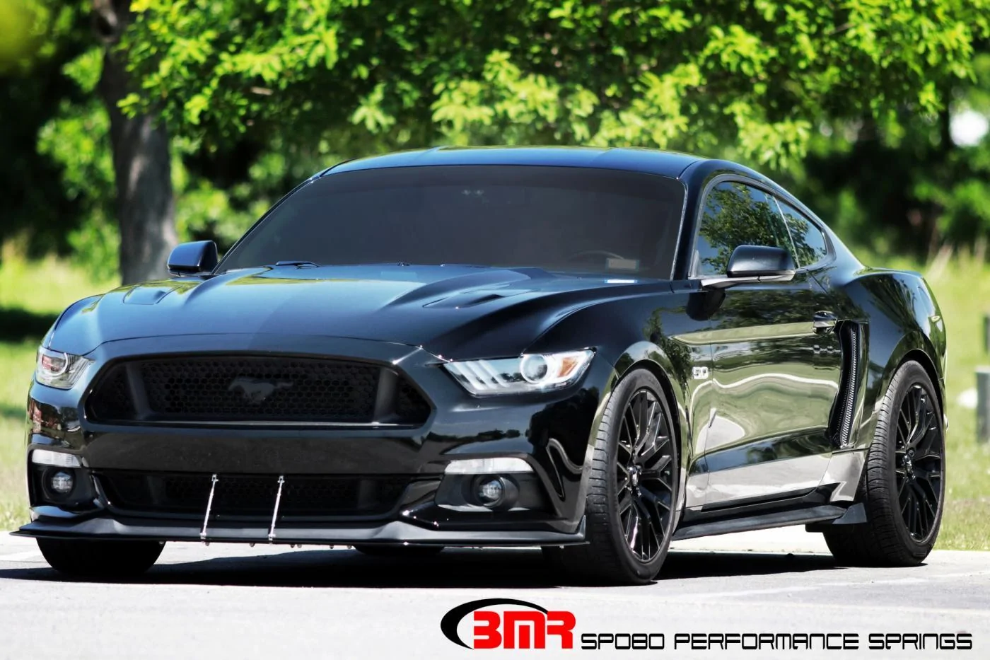

The one and only, BMR SP080

Remove stock springs.
Trim bumpstops per instructions.
Install BMR SP080.
Verify alignment is okay, adjust toe accordingly and bring the camber out a touch out back.
Enjoy the best all-around Performance Springs for the S550 Chassis.

I haven't tried the SP080, but I've tried enough spring combinations to tell the BMR Performance spring rates are spot on.
+1 vote for the BMR SP080.
Pair with some good shocks if you can afford.
