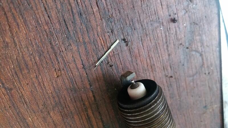

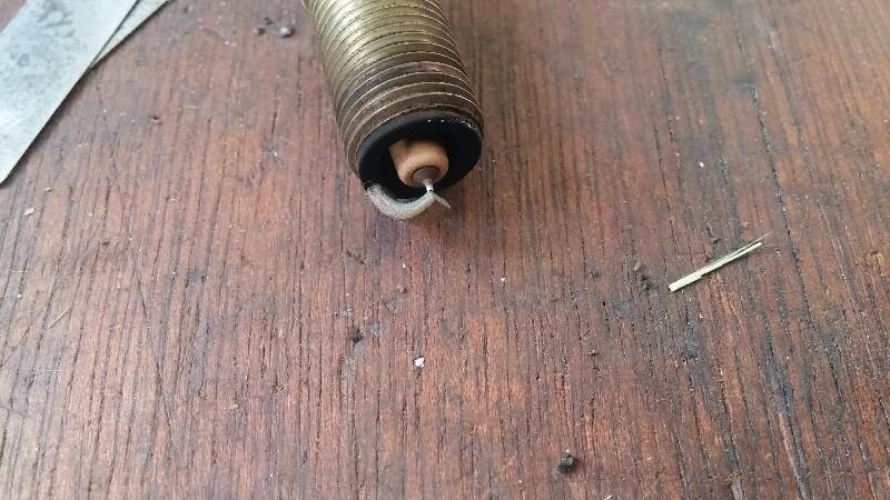

I was just checking to see if this was about normal. When I bought the car they said they just changed the coil for a miss fire. So today I figured I'd check my plugs. I could see one coil looked cleaner. I pulled that one first. Plug was about 1/2 turn loose. Checked gap. Was 028 and very clean looking. I assume this plug was also changed 5000 miles ago. Then I pulled other plugs. They have 30000 on them. Very squeaky on the way out and they looked darker. Gap at 032. I assume they are darker just because of the more miles?

I'd assume your assumptions would be correct. The plugs with more miles will definitely exhibit more wear, e.g. darker, sooty, worn insulators and electrodes. Given the mileage gap of 25,000 miles, they'll, without question, look different. I usually change mine every 10k-15k miles depending on their condition.
Based on your pics, the 30k plugs do look a little worn, but nothing that'd cause concern, in my opinion. I'd definitely gap them to 0.028 like the newer plug and make sure they're all properly tightened.
