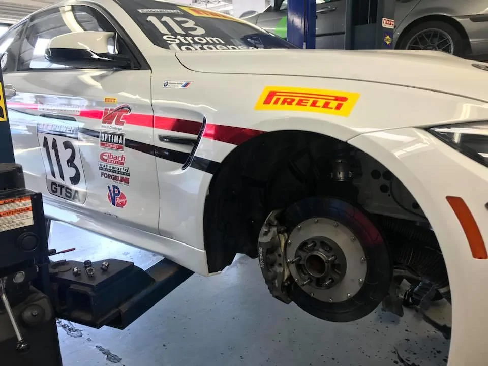

It sounds like you are looking for bolt-on spacers, is that correct? I'd highly encourage you to get slip-on spacers paired with extended wheel studs from ARP or MSI. This setup is much safer than the bolt-on options out there and is battle proven in professional race series across the world, as seen here on Strom's PWC racecar.
- Cory
Where do you get the black wheel studs? I want to add slip on spacers to my car but do not like the color of the ARP wheel studs. They seem like a clash with the black Performance Pack wheels.
