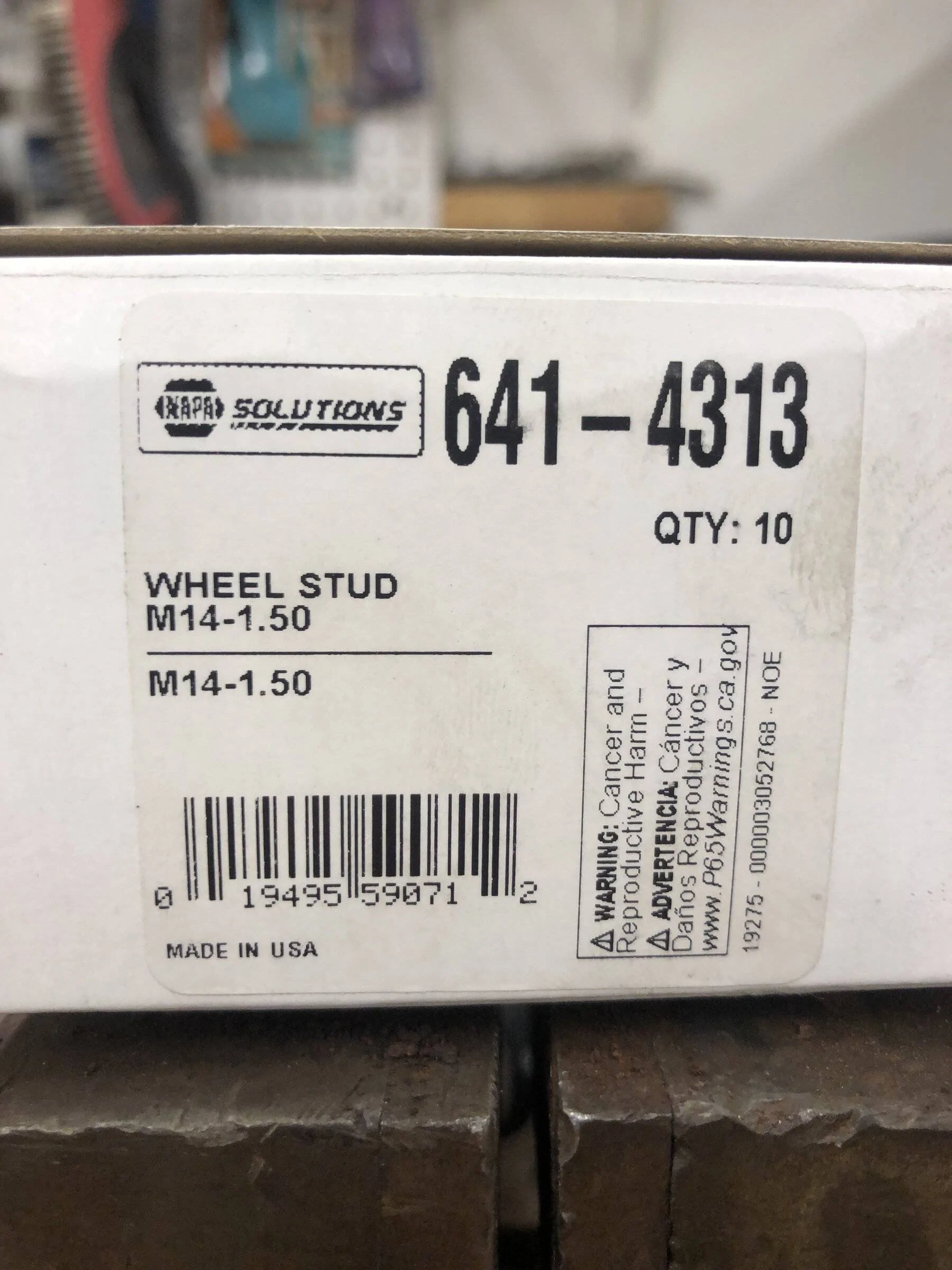

When I wanted to add slip-on spacers to my 2017 GT PP but didn’t want to spend a small fortune on the ARP set I researched the sizes and discovered that stock studs from an F350 DRW would work perfectly. I got a full set from NAPA for around $120. I knocked out the stock studs and the truck studs went right in. The knurled area was the same. The stock lug nuts were compatible. I was pleasantly surprised that it all worked out.

This is what I used instead of the ARP version. They’re for a Super Duty so I figured they would be fine.
Replacing the front studs was simple, the rear studs were much more involved.
