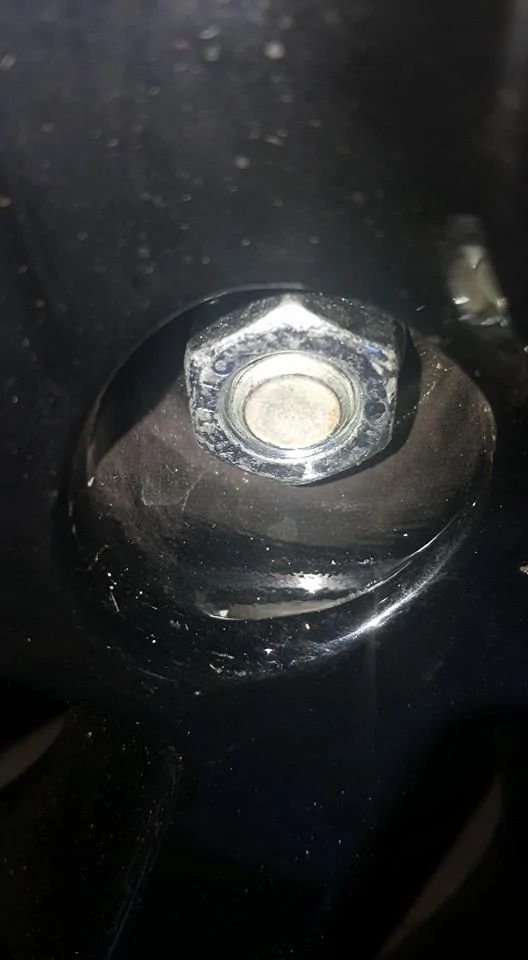

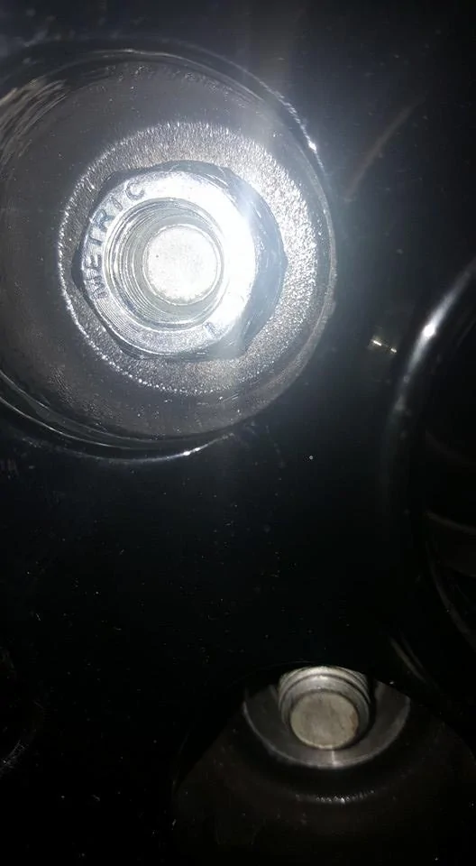

Optimum Performance
Gold Sponsor
Mar 13, 2016
1,836
1,395
Titusville, Florida
www.facebook.com
Tommy
'15 GT PP
Hello. The offset on the AMR rims I went with aren't aggressive enough so I'm looking to push them out a little with the 10mm spacers here https://www.motorsport-tech.com/wheel_adapters_pop_car_d1
Will I have enough thread on the stock studs to properly secure the tires? Hopefully but if not, how hard is it to change to studs to something 10mm longer?
Thanks,
We used to recommend it was ok to run a thin spacer with the stock studs but we do not recommend any spacers on the factory studs. They are just too short. The two pictures illustrate this. The one with the nut flush to the top of the stud is on a factory PP wheel with no spacer. The picture with the stud about .300" inside the nut is with an 8mm spacer.
To have 14mm of thread engaged the maximum you could run would be about 5mm spacer and this is a compromise because you are giving up about 25% of a typical lug nuts engagement surface. Roughly the standard is 1.5 times thread diameter. The nuts used in the picture have about 20mm of thread area.
Again, you are free to do what you want but WE do not recommend it.
