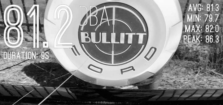

Thanks for the links.
I'm installing the catted H pipe next week.
Here is my base line using a very non scientific, non calibrated iPhone app - 81 DBA

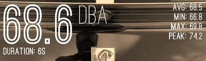

Also, here is my GT350 with stock exhaust set to "sport" - 68.5 DBA Ave
