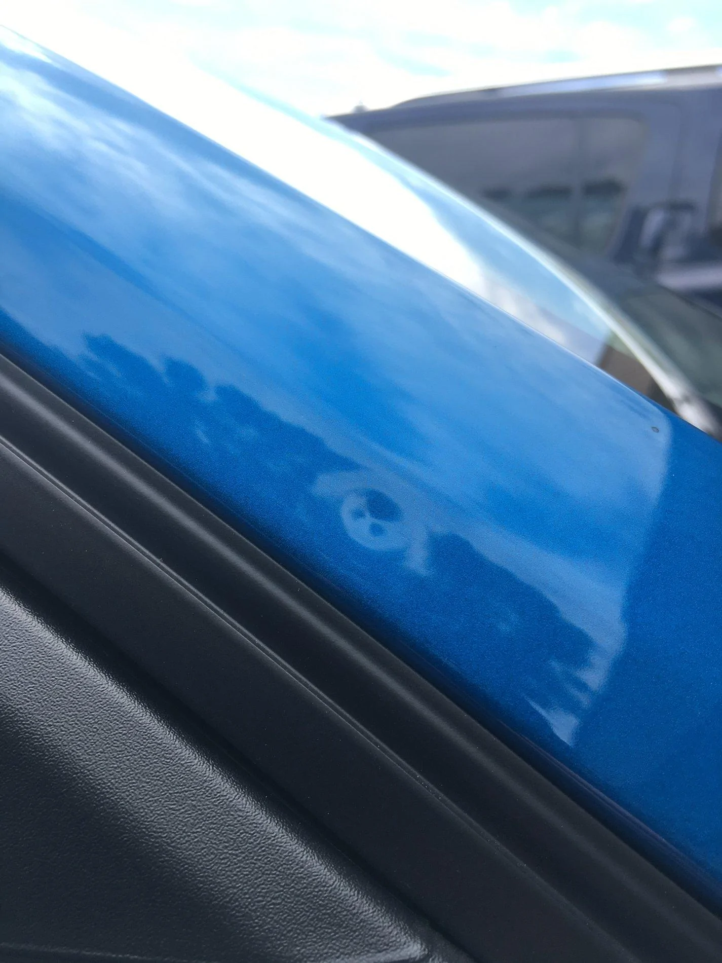

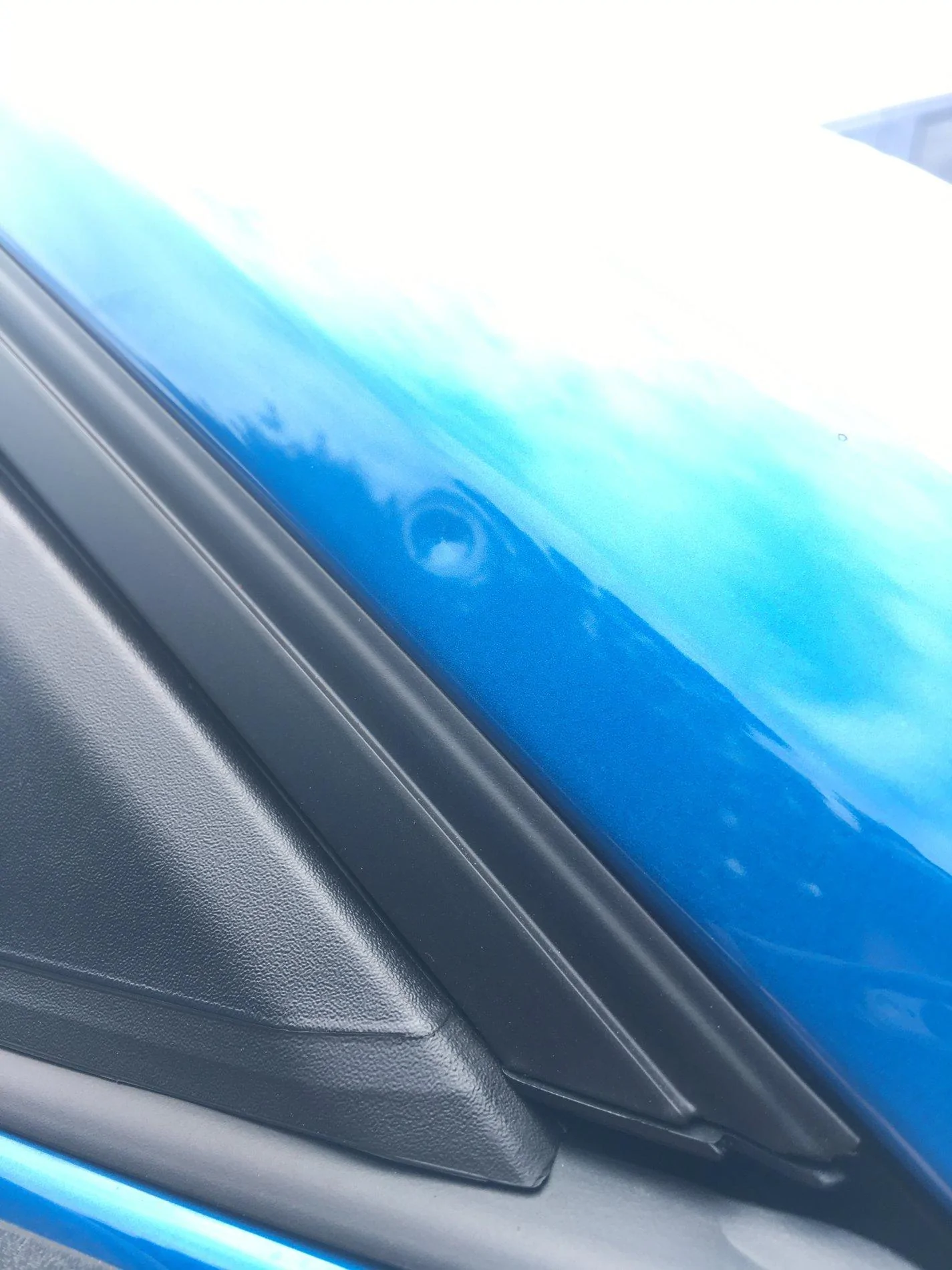

Noticed this tiny dent on my passenger side a-pillar when I got home with the car. It was definitely on there before I bought it (went back and looked at pics). I'm sure the dealer would fix it if I told them, but I don't really want to make the 2 hour trip. Is this little dent easily pull-able by a PDR guy? It's about a half inch around, no paint damage. The location of it is a little concerning, though.

I have used a PDR guy on several occasions.
Normally they will attempt to push the dent out from the inside and pulling is a last resort.
If the A-pillar trim can be removed, there's no reason that a competent PDR guy can't make that disappear.
