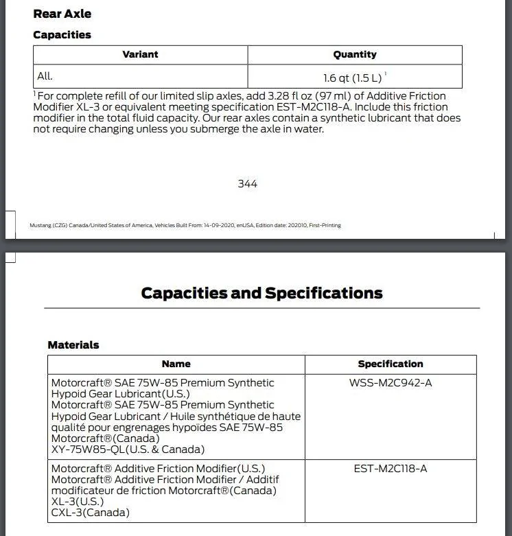

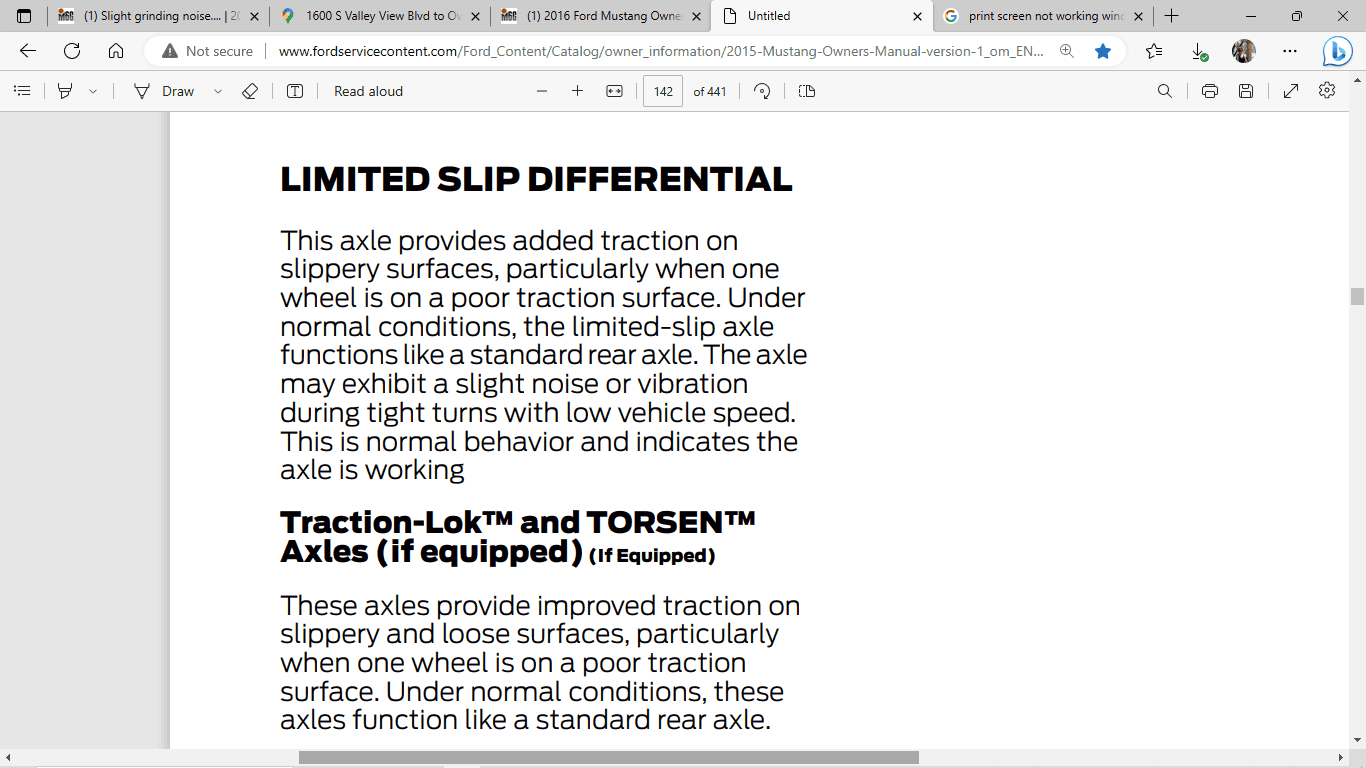

You might want to check before you eliminate -to my knowledge all S550s have a limited slip differential, my 2016 V6 definitely does. It'll be a Traction-Lok. This is from my owners' manual: HTH

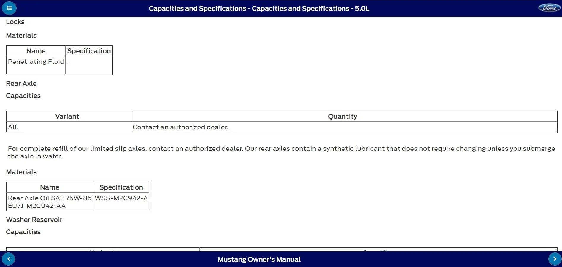

So UK manual (no friction modifier) :
USDM manual (with friction modifier) :
So a call to my tech confirmed no friction modifier, no mention of it on their system.

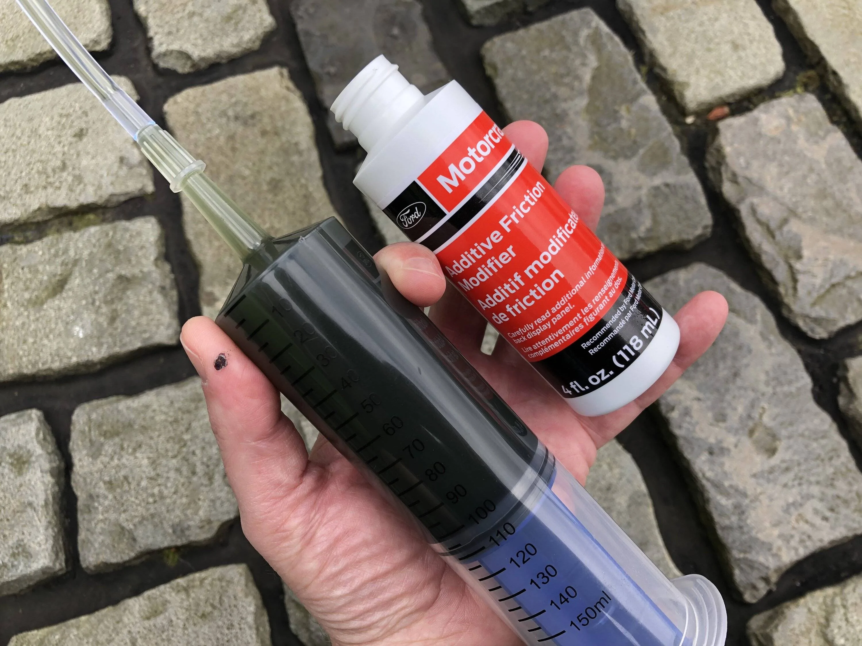

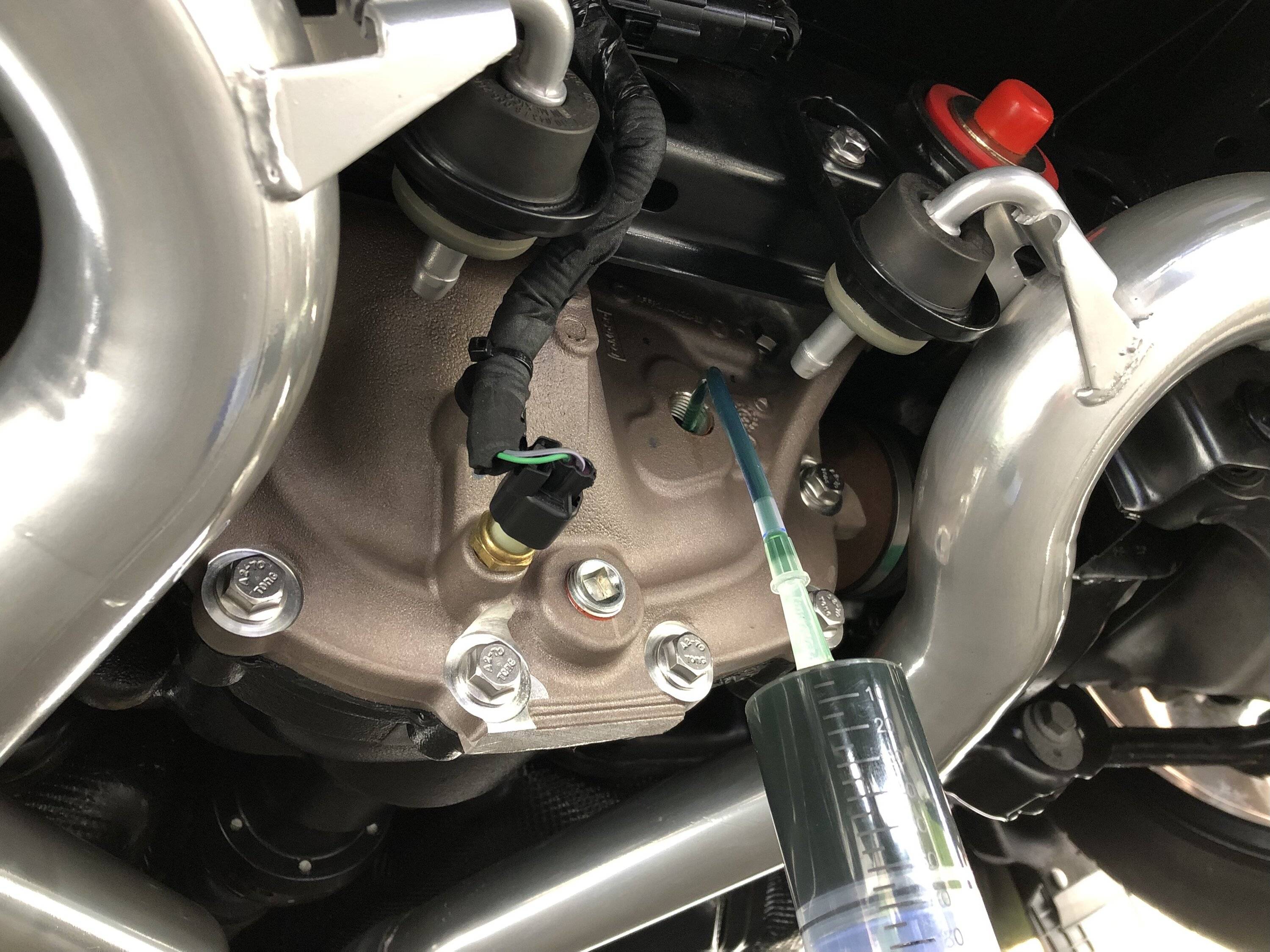

So I bought some of ebay (£13 delivered :sunglasses:) along with some big syringes from Amazon and spent a bit of time under the car :
Sucked 130ml out, squirted in the friction modifier, squirted oil back in to bring the volume back to where I started (I will check it again when cold / level) :
I immediately did a full lock turn in the street, the chatter was significantly reduced.
