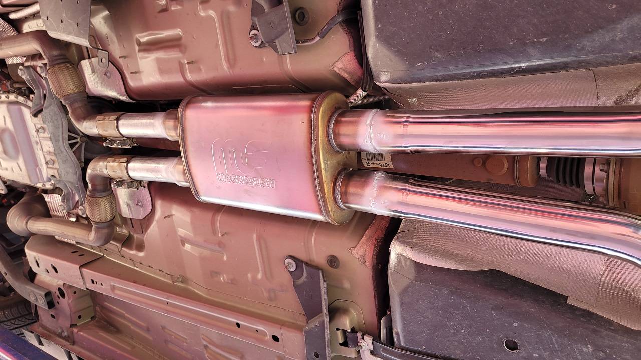

With my 3.7 I did away with the mufflers and resonator. In place of resonator I have this
https://www.amazon.com/gp/product/B002HCA8B0/ref=ppx_yo_dt_b_search_asin_title?ie=UTF8&psc=1
in place of the mufflers I have 2 small glass packs.
At first I changed resonator to the link above and it was to quiet, I then took off rear mufflers and put on glass packs. It sounds good but has a slight drone at 1600 to 2000 RPM.
I will replace the rear glass packs. Would a chambered muffler help?

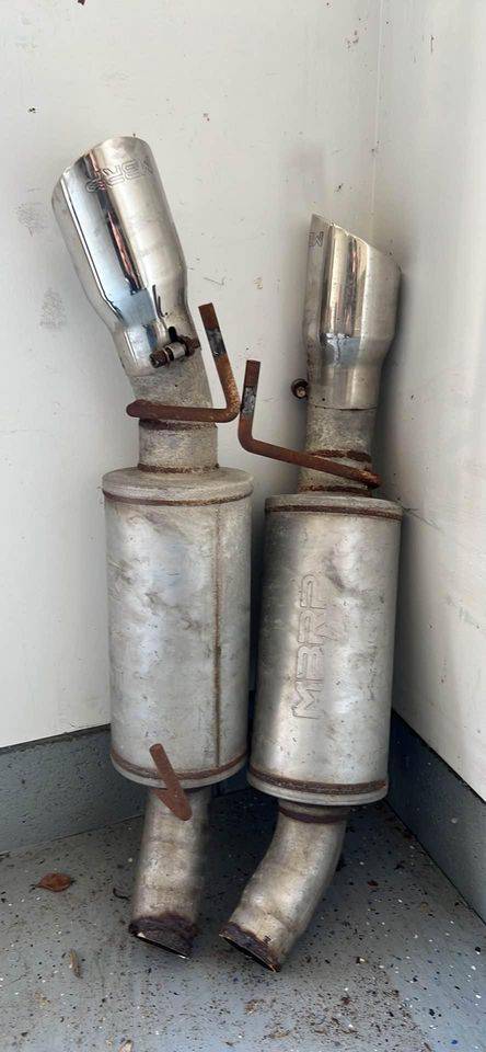

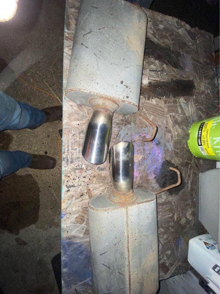

Here is what I c an get
or
for less than 100. Which would be better with the midmufflers I have?

It's hard for someone to give advice on a mix and match frankenstein type exhaust that no one else has installed. I would assume the bigger oval mufflers would have less drone, but it depends on whats inside.
I have the MagnaFlow resonated "X" muffler and the SVE's 2015-2017 Mustang GT cat-back that has similar mufflers as your second pic. There is drone, but I am use to it. Also I just try to drive outside of those RPMs when I can.
