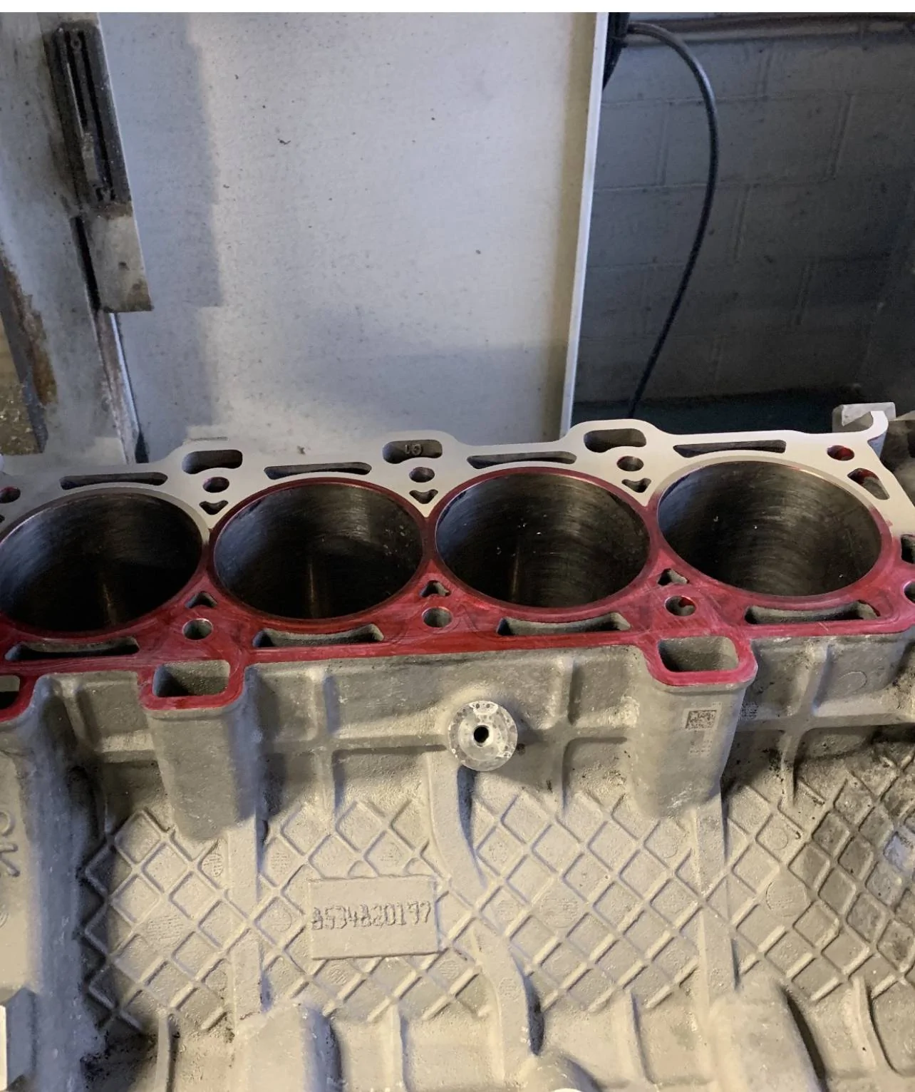

I did have an MMR sleeved 5.2 SB that was blowing coolant/head gaskets that turned out to be due to dropped sleeves .
My man Fonzie was able to fix it ... I ended up selling the long block to a buddy when he did but now wish I had kept it .

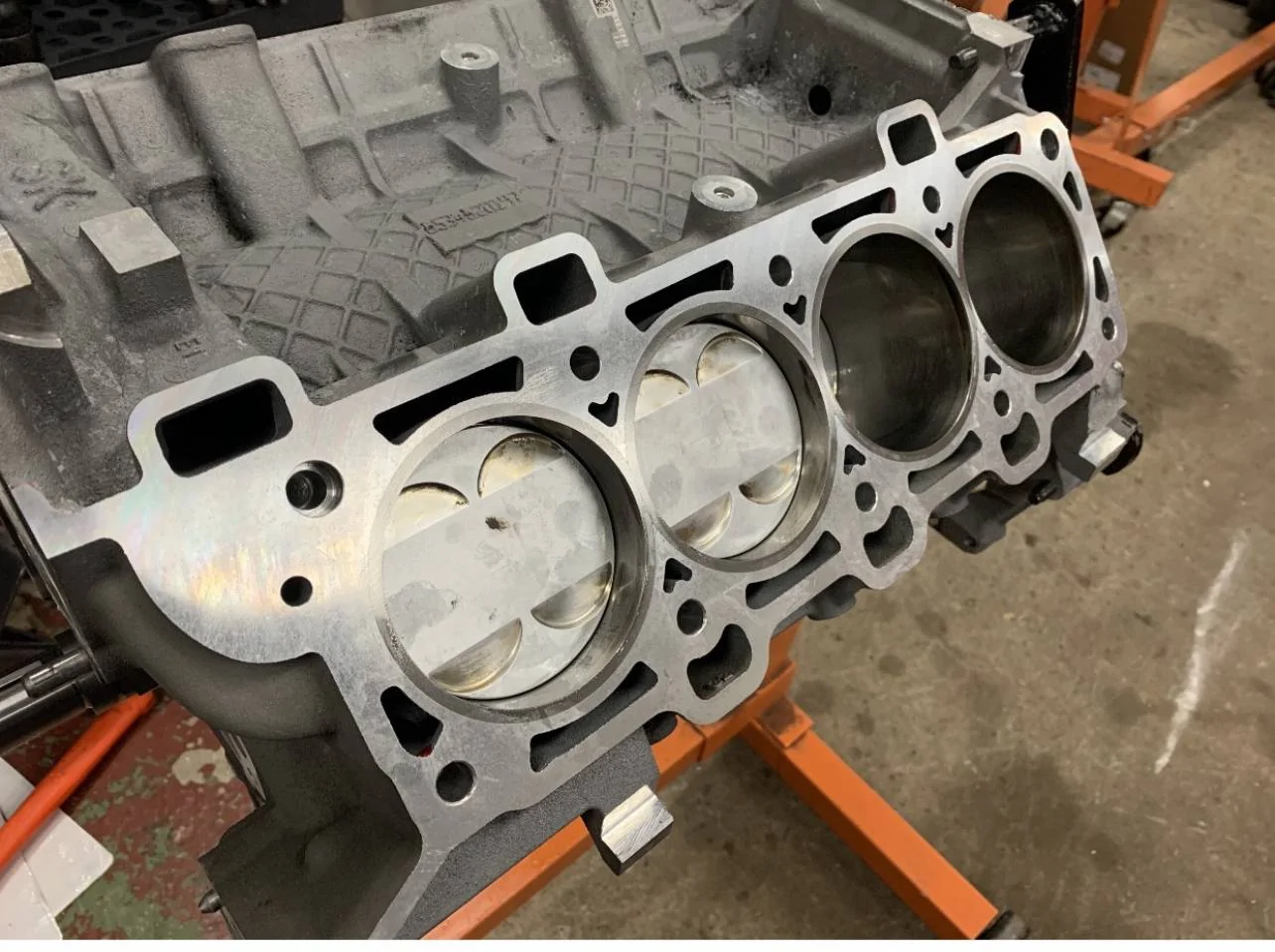

Before and after pics
After diagnosing and fixed .

I was actually able to salvage that block/rods . I had it rebuilt by L&M with Diamond pistons and still have it .
Converted to use 12 mm head studs .
