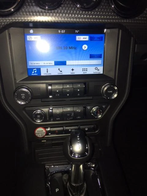

I posted this in the Raxiom unit thread, and figured this may be a good place to post here too.
I like to think for the future, and how I can help myself down the road. With that in mind, I'll mention a couple things I did during this install that I think everyone can benefit from.
While the trim was out, I took .5" door insulation and stuck it all over the area that the trim clips into. This was to prevent creeks, rattles or pops that the plastic trim makes.
Additionally, I put a strip of black electrical tape around the clips so they don't rattle around, or break and fall into the dashboard. This will also make it easier if I have to pull the trim out again.
