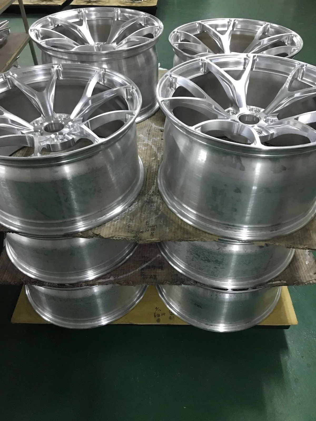

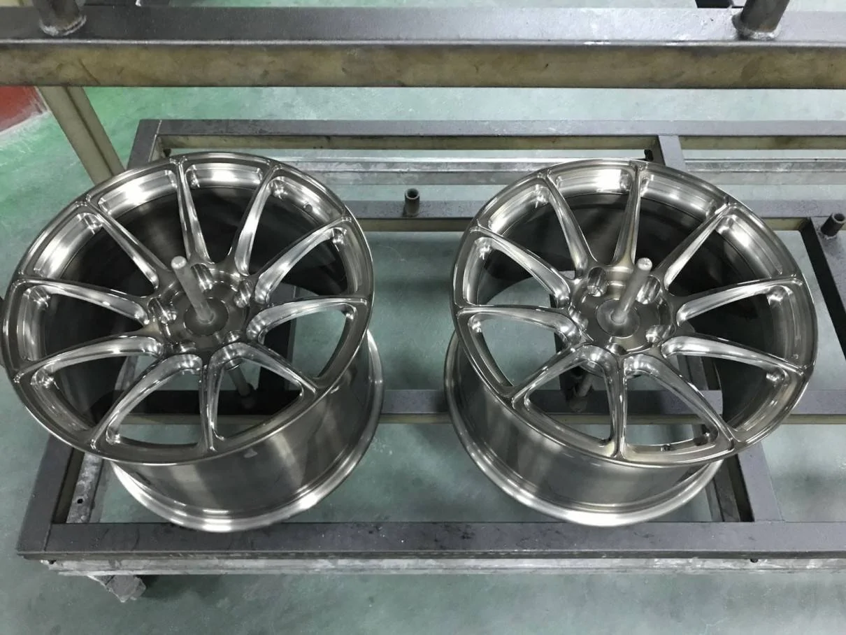

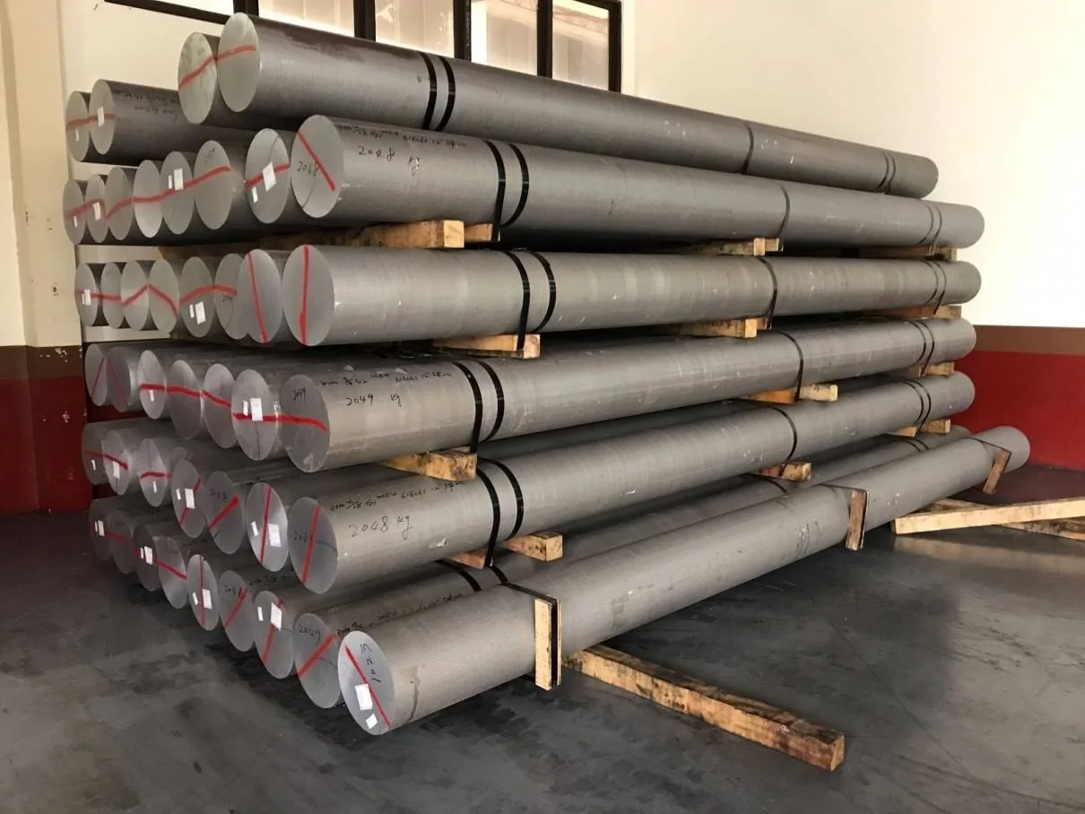

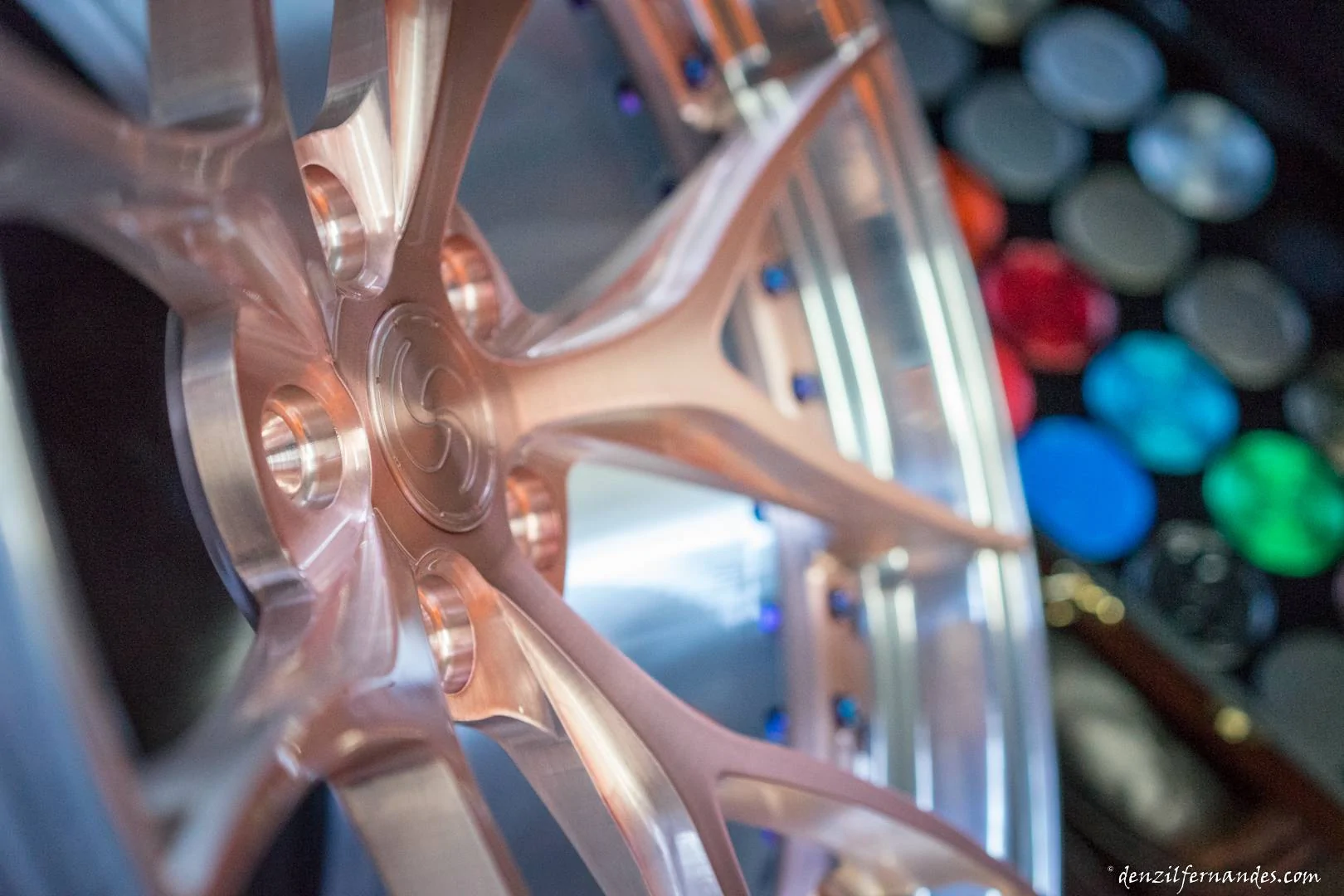

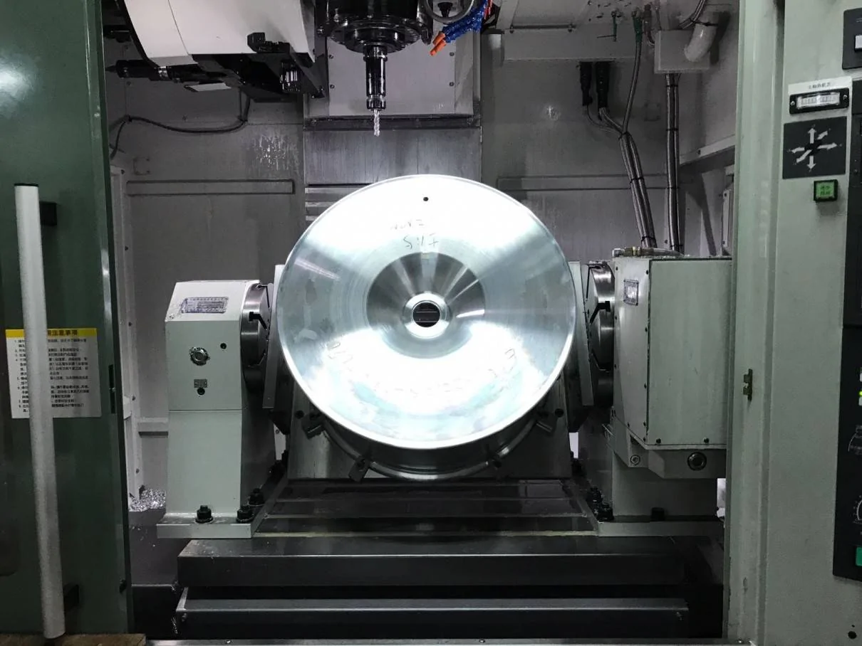

All of our wheels are CNC cut from forged aluminum and come directly from machining in raw form. From there each wheel is hand cleaned, deburred, and brushed to prep it for coating.

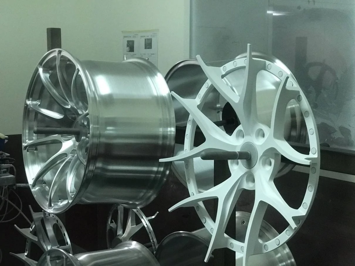

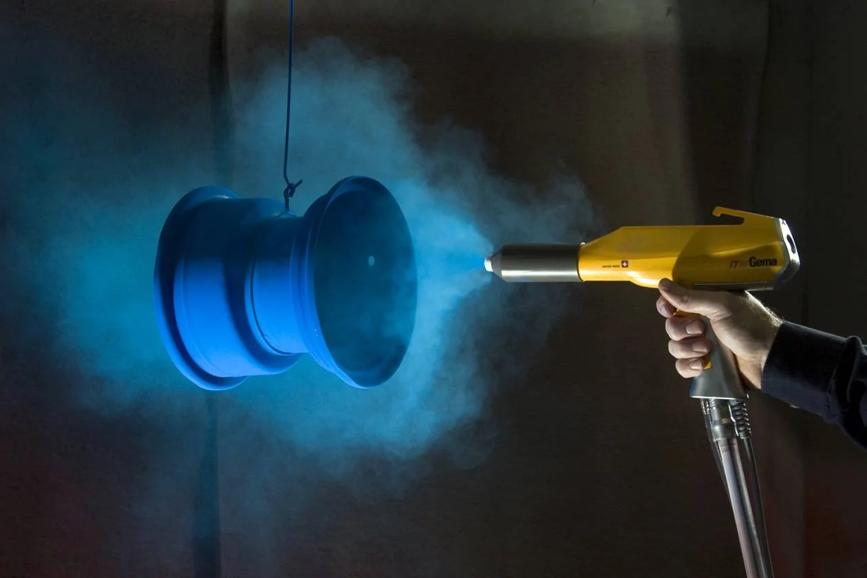

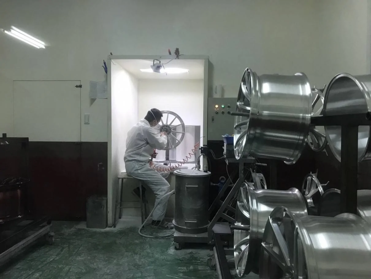

All of the wheels we offer come powder coated, and not painted. Powder coating is far more durable in terms of battling environmental contaminants, heat, and longevity. What is powder coating? Powder coating is a type of coating that is applied as a free-flowing, dry powder. Unlike conventional liquid paint which is delivered via an evaporating solvent, powder coating is typically applied electrostatically and then cured under heat or with ultraviolet light. Every wheel we powder coat is mixed with an in-house formula, and is done specifically for that wheel being built. This ensures consistency between the wheels, and these colors are not available from a catalog.

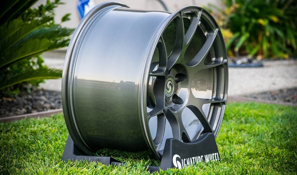

Standard finishes are solid in color and have a base coating that covers up all of the forged aluminum.

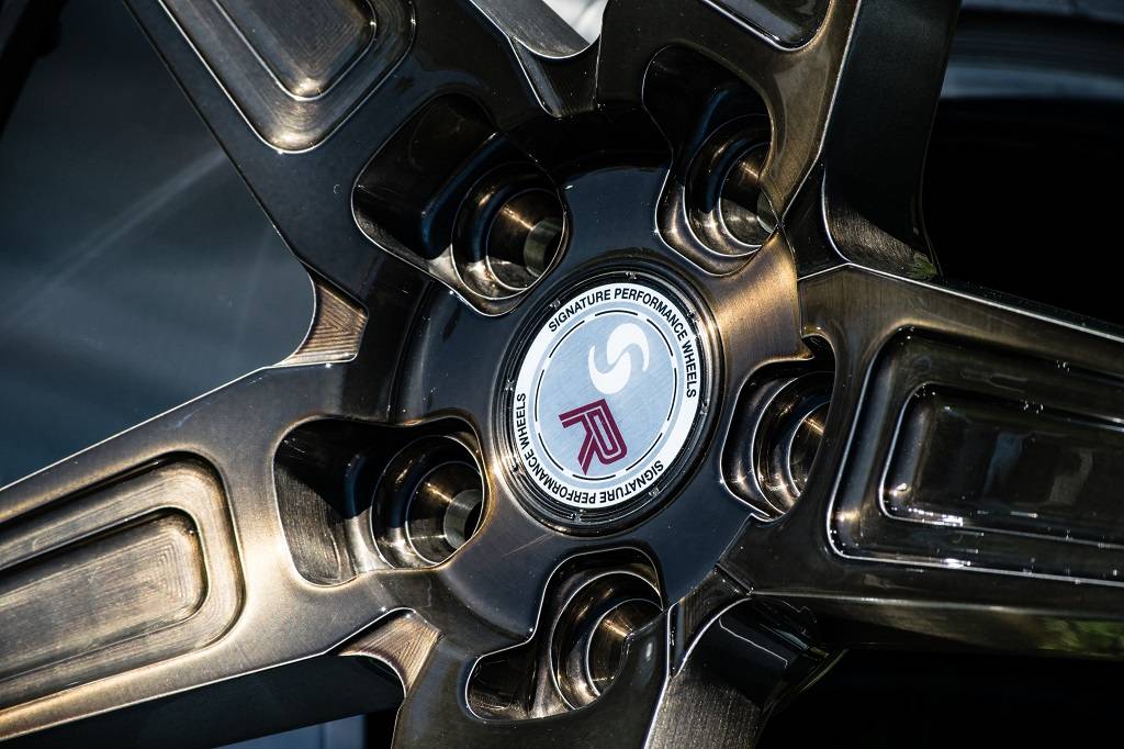

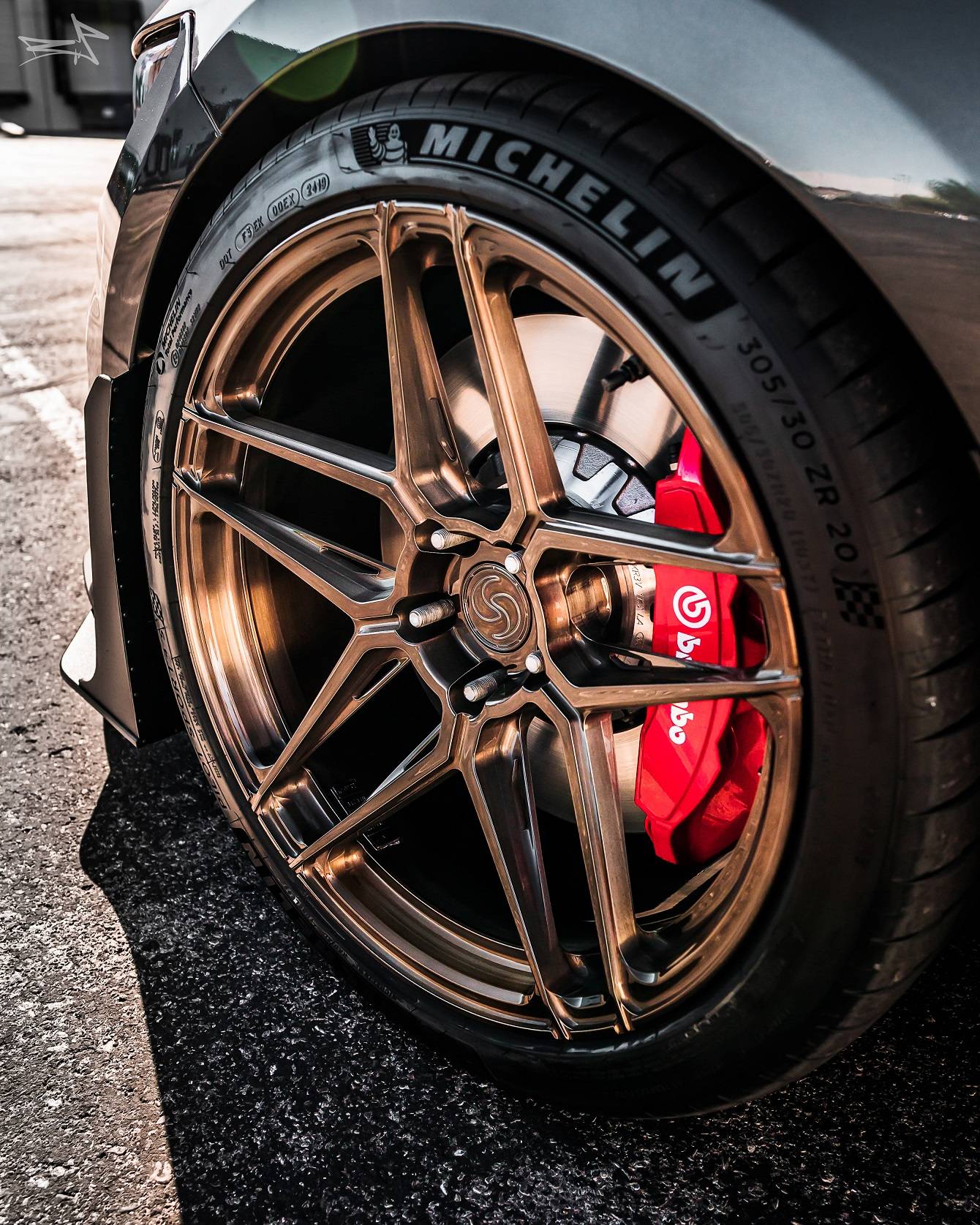

Translucent finishes are a powder color mixed with a powder clear coat that allows you to see through to the brushed aluminum below. Probably some of the coolest finishes we offer, and the hardest to match if damaged.
